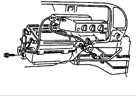

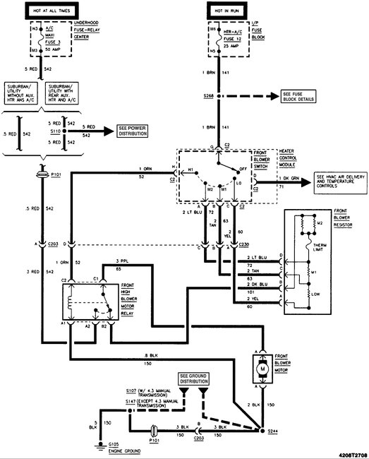

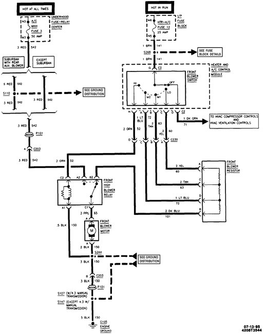

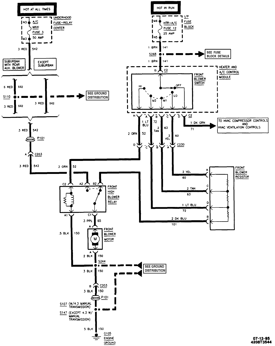

My wiring for my blower motor is wrong so I got another wiring harness for the passenger side. On the old one there is not enough of the wires the new plug has more.
Nov 24, 2017 at 5:36 AM
STEVE W.
  • 15,345 POSTS
Then the replacement harness is not correct. There are two versions for that truck, one has AC the other does not. The wires to the blower motor itself are simple. One power One ground. The rest depends on which control system you have and if it has AC or not.
Nov 24, 2017 at 3:32 PM
BABYJAY531
  • 89 POSTS

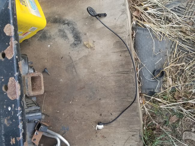

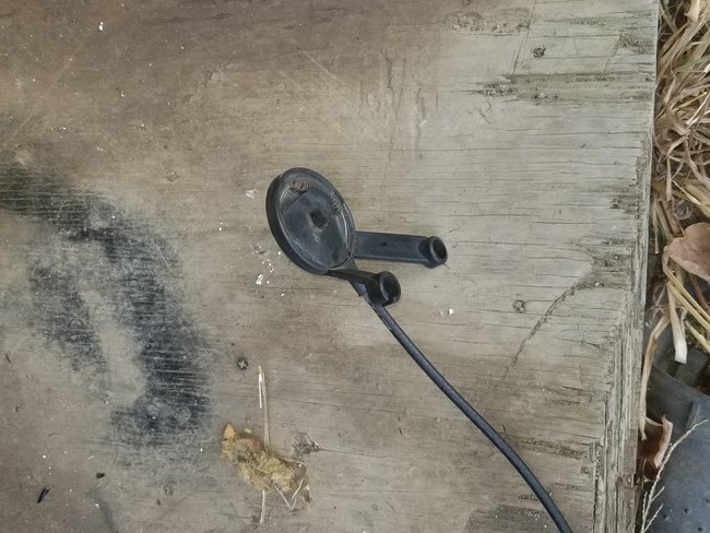

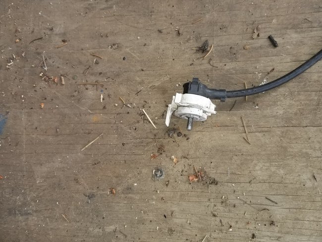

Okay, now the old wire that is like a bike brake wire the connects to the heater switch.
Nov 24, 2017 at 9:02 PM
BABYJAY531
  • 89 POSTS
This goes to the heater controls.
Nov 25, 2017 at 12:48 AM
STEVE W.
  • 15,345 POSTS
That is a manual mode control cable, used on the systems that do not have AC. It is either for the heat/defrost control or the hot/cold. Depends on the part number. Should be two total.
