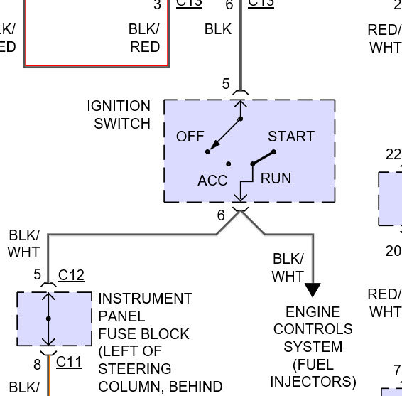

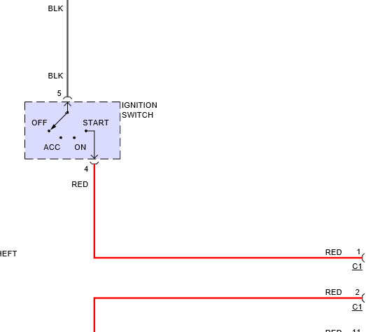

The ignition harnest was cut and now I do not know which wires to which.

the wires should be color coded here are a few pictures.
