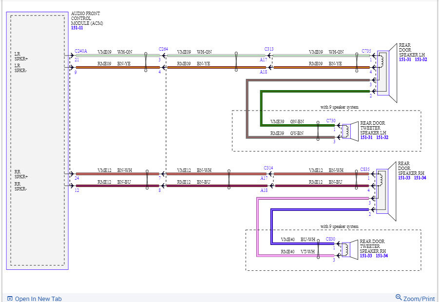

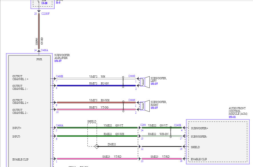

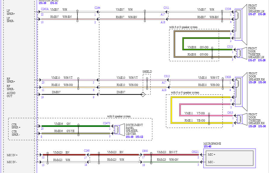

I'm installing an audio adapter for sub woofers and need a wiring diagram for the car listed above to see what color wires go to the speakers so I can tap into them for the adapter.

Here are some diagrams of the speaker wire colors. Let us know if you need any more. Check out the diagrams (Below). Please let us know if you need anything else to get the problem fixed.
