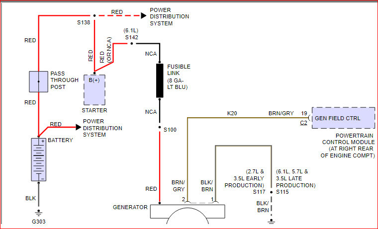

So I changed alternator and noticed that there are some cut wires running by the alternator and they are glued. Seems like it was done on purpose. I just purchased this car. Can anybody help or give me advice?

I have attached a picture of your charging/alternator wiring diagram. If you need any other diagrams of the wiring let me know. I have also attached a link showing how to test. Hope this helps and thanks for using 2CarPros.
