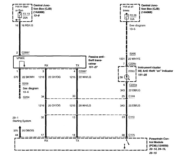

I had to get a new PATS ring for the cylinder (key). I am missing wires at the plug going to the I think anti-theft box.
I reset the PATS, but no fuel pump guess on.

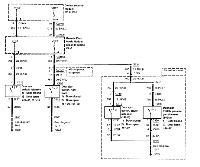

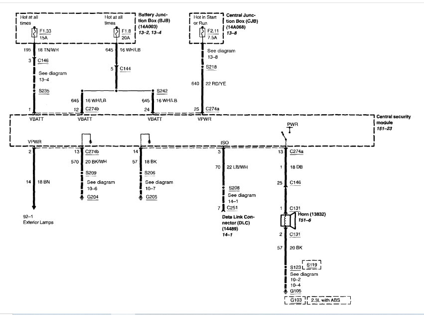

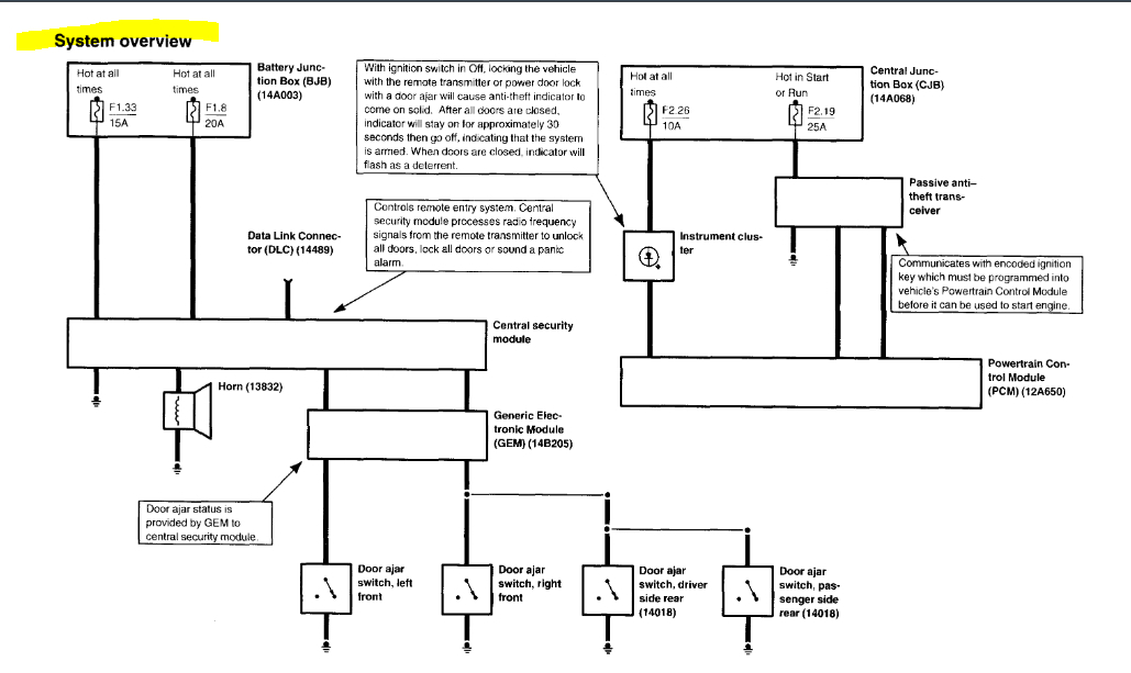

Next, I attached what I have for the antitheft system schematics below. The very first pic is an overview of how the system works. The remaining pics are the wiring schematics.
