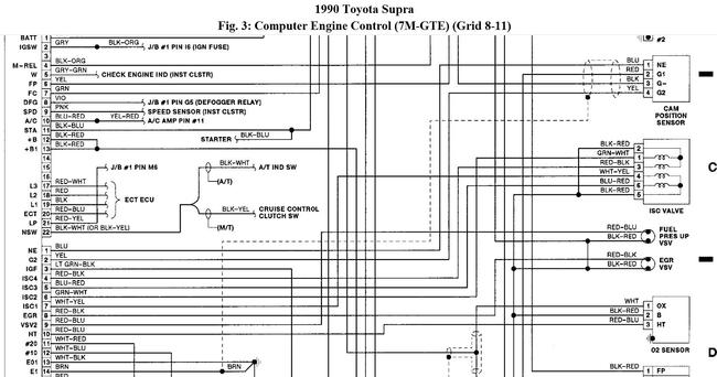

Need wiring schematic for a 7m-gte engine in a 1990 ceiica supra. Turbo manual transmission

check with a library or Haynes these are to big to send on a reply

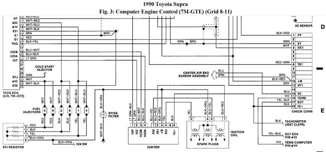

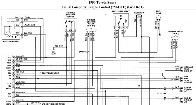

See if the following is of any help.
