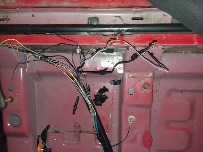

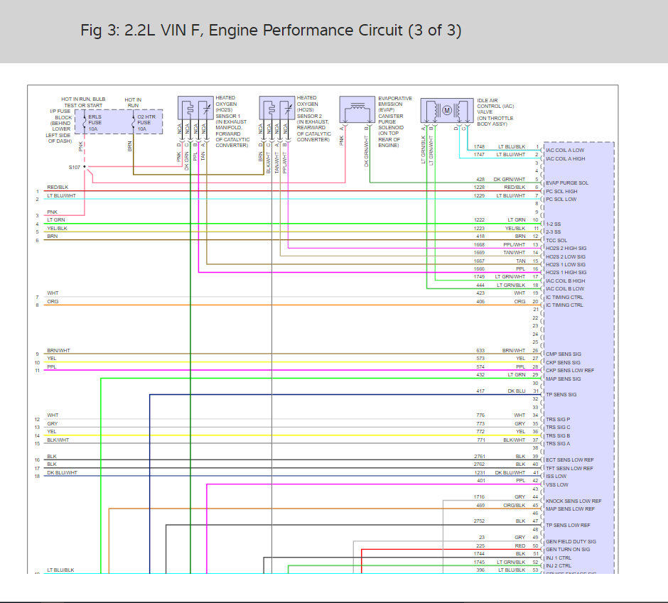

Hello, I did something really stupid. I am racing this car so I cut the wires they are below the carpet on the passenger side now the fuel pump won't come on which wire would fix that?

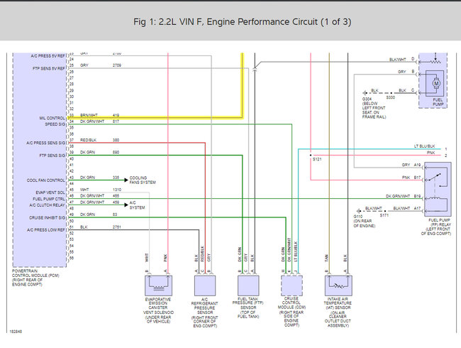

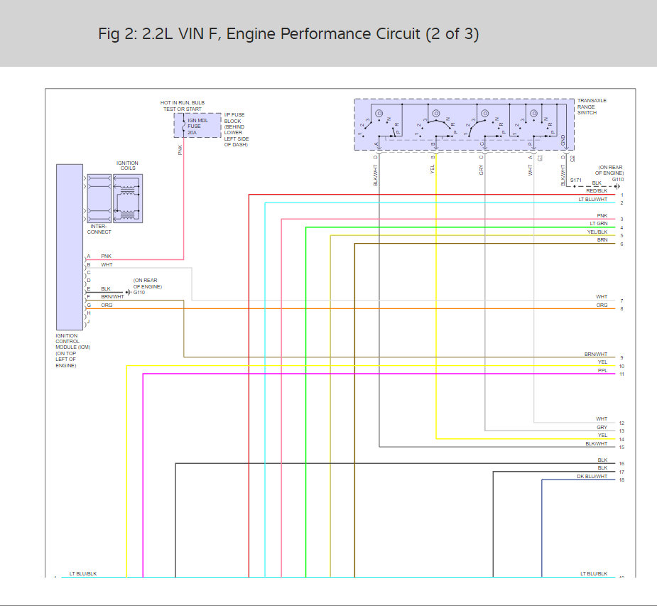

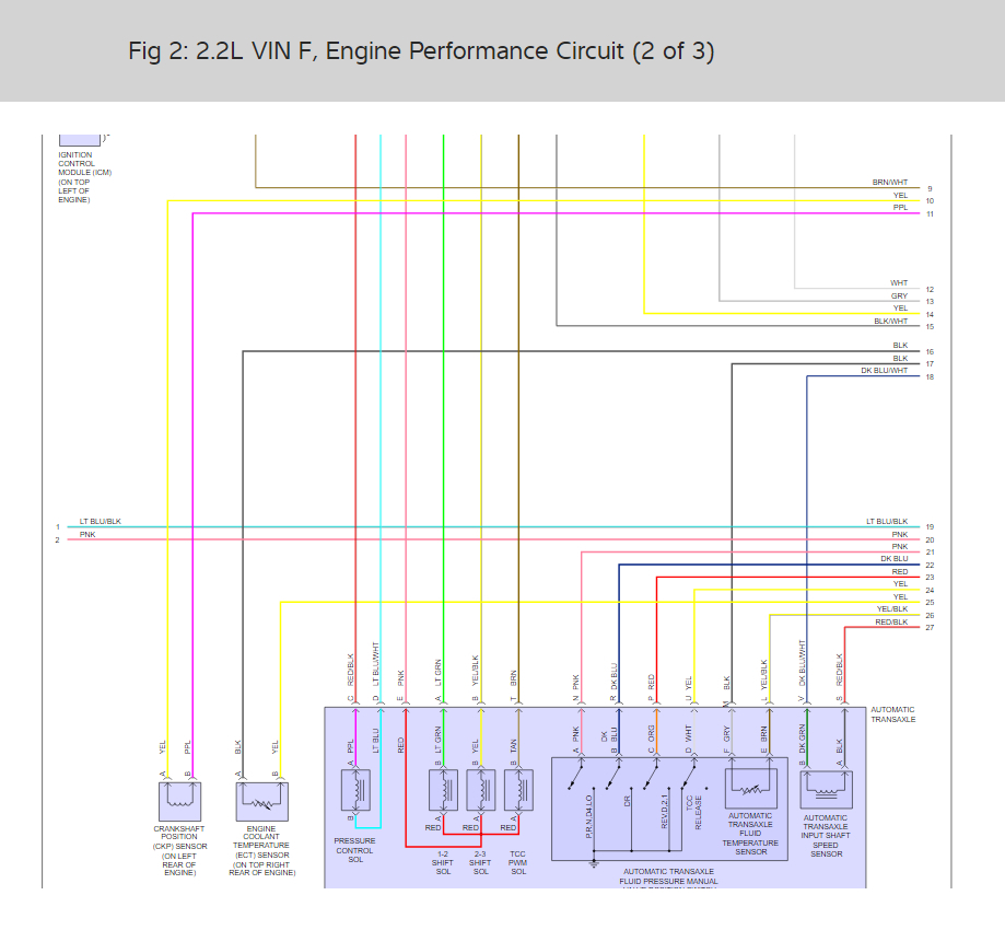

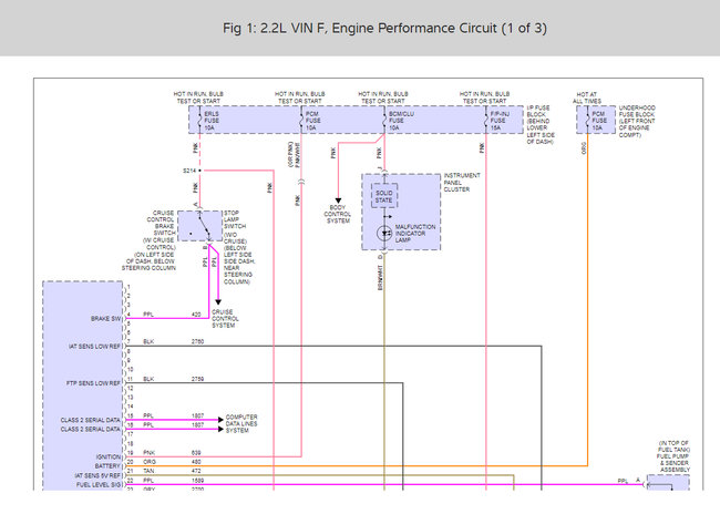

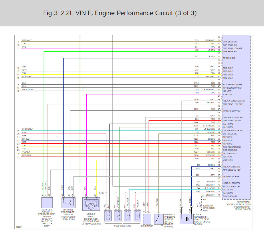

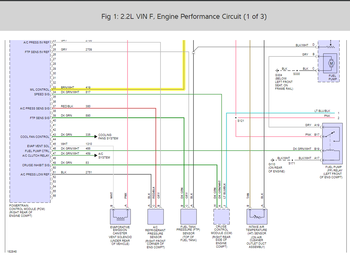

Are the wires color coded? I would use butt connectors and attaches, let's say for instance, if you cut a blue wire with a white stripe, a green wire, and a yellow wire. The blue with a stripe wire to the blue with a white stripe, the green wire to the green wire, and the yellow wire to the yellow wire, and so on. In the diagrams down below I have included the Engine Performance Circuits Wiring diagrams for your vehicle. It looks like the dark green with white stripe is providing switched power to the control side of the fuel pump relay, the pink wire is coming from the fuel pump (15A) fuse from the Instrument panel (IP) fuse box to the power side of the fuel pump relay, and the gray wire is supplying battery +(12 volts) to the fuel pump via the energized power side of the fuel pump relay to the fuel pump, and the black wire coming from the fuel pump grounds to ground#304 underneath the left front seat frame rail.
Thanks,
Alex
2CarPros

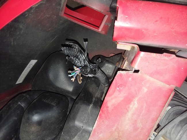

The picture on the left is below the passenger seat and I also cut the wires in front of the motor which is the picture on the right. I thought all those wires just went to the lights speakers stuff like that. I didn't think it was anything major.
Mar 14, 2019 at 6:54 AM
If that is the case, then that is not the harness for the fuel pump. Look under the car at the pump and follow it back.
Mar 14, 2019 at 5:07 PM
DADDY8192003
  • 9 POSTS
So what are the wires that are inside the car on the passenger side that run under the seat?
Mar 14, 2019 at 5:10 PM
Where do they go when they exit the floor?
There are so many wires that color, I need an area.
