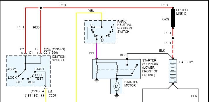

Color of wires including fusible links on solenoid and where they lead to. A diagram would be a great help. .

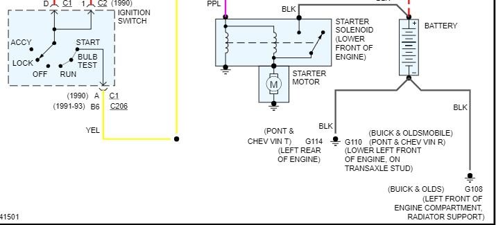

I attached the starting system schematic. I had to cut it in two to get the entire picture. However, I did overlap it so you can easily follow it.
Let me know if this helps.

The diagrams help me considerably. There are two rusty colored fusible links going to the solenoid. Do you have a diagram of the front of the solenoid showing or telling what the fusible links are for and what part they represent? Including other wires to the solenoid.
