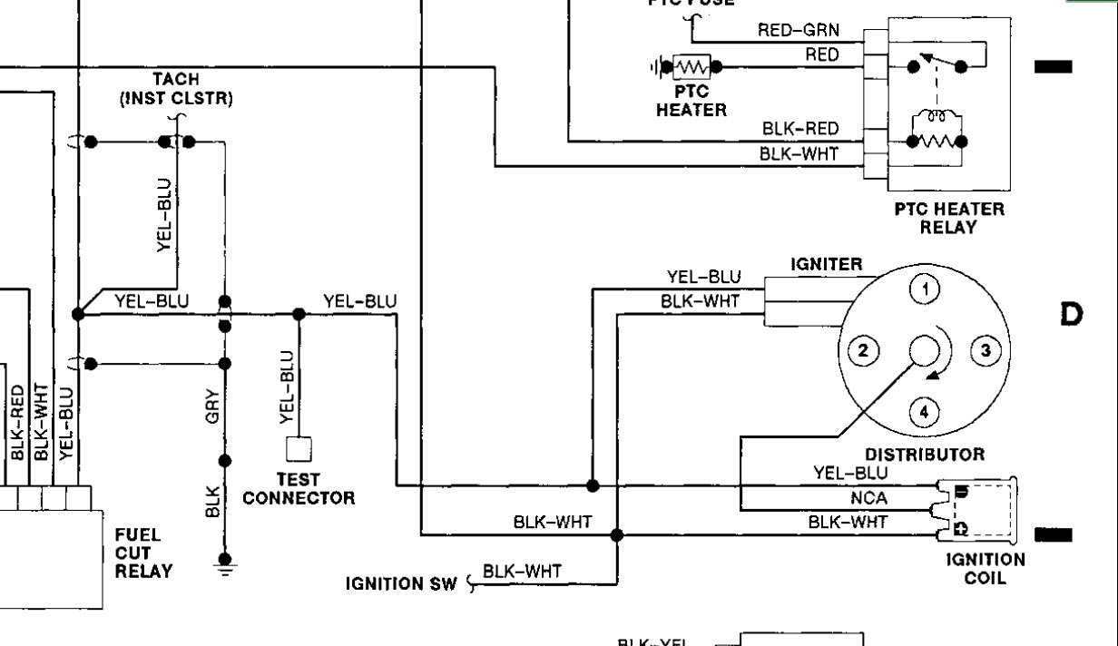

the four wires that go to the plug that plugs in the distributor i need to know the way that they hook back up. i see the color coming from harness but cannot see on the plug the same. how do i hook them up the proper way?

picture shows a b2200 not a 2500 as we do not list that it is a 2.2L however.
