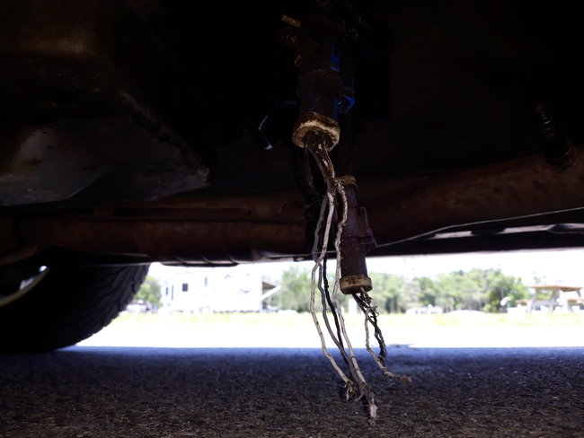

The car had been sitting for five years. I think a rodent may have chewed through some wires in middle area of car underneath. Now there are two different plastic pieces with several wires coming out of each one.One is more on the drivers side and is blue. The one more on passenger is grey looking I think. Middle area of car and they are hanging almost dragging to ground. ?? They look like the pieces may have possibly been connected by the wires? It is a GT model, convertible.

It's like right in the middle kind of where the transmission, automatic , is. Zoom in on this picture. It's hard to get under there to take the picture.

Those are oxygen sensor wires.here is a guide to help you replace the sensors which will come with new wiring:
https://www.2carpros.com/articles/how-to-replace-an-oxygen-sensor

Thanks so much. I just replaced them yesterday!
