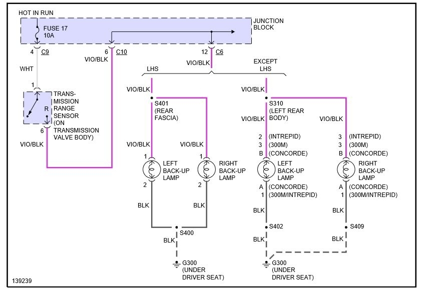

How would I go by putting my wires back together and how would I know if I am missing any wires? Reconnected as far as color coding, but I am still not getting any reverse lights. What would be my next move?

Hello there, thanks for using 2CarPros.com. Seems to be a tough problem with ripped wires, where are the wires exactly that got cut? I see there are ground wires for the rear lights under the driver seat as well. Hopefully this is the right diagram, it is for the 3.2L engine.
