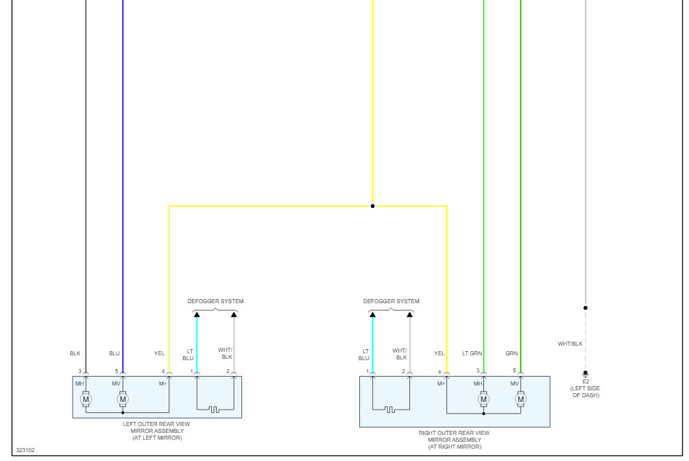

I need a wires diagram for 2010 Matrix heated mirror.
It has 5 wires.
I want to know which ones are positive and negative for heating the mirror.
Thanks
Oct 3, 2022 at 10:09 AM
SQM
  • 6,383 POSTS
The heating element wires should be the light blue and white/black.
See wiring schematics below for your reference.
Let me know of any questions.
