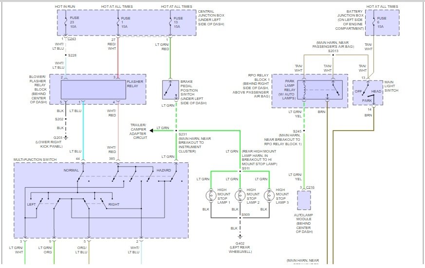

Wiring diagram for tail lights and blinkers needed
2000 FORD EXPEDITION
80,000 MILES • 5.4L • V8 • AWD • AUTOMATIC
STONE42011
The wiring harness for my blinkers and tail lights has come apart and I need a diagram. can you help me?

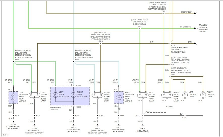

Here are two screenshots of the Exterior Lighting wiring diagram from "Prodemand"
The first is the top/second is the bottom.
When I shot them, I insured there was a little 'overlapping' so that you could see nothing was left out!
Let us know if this is what you needed.
