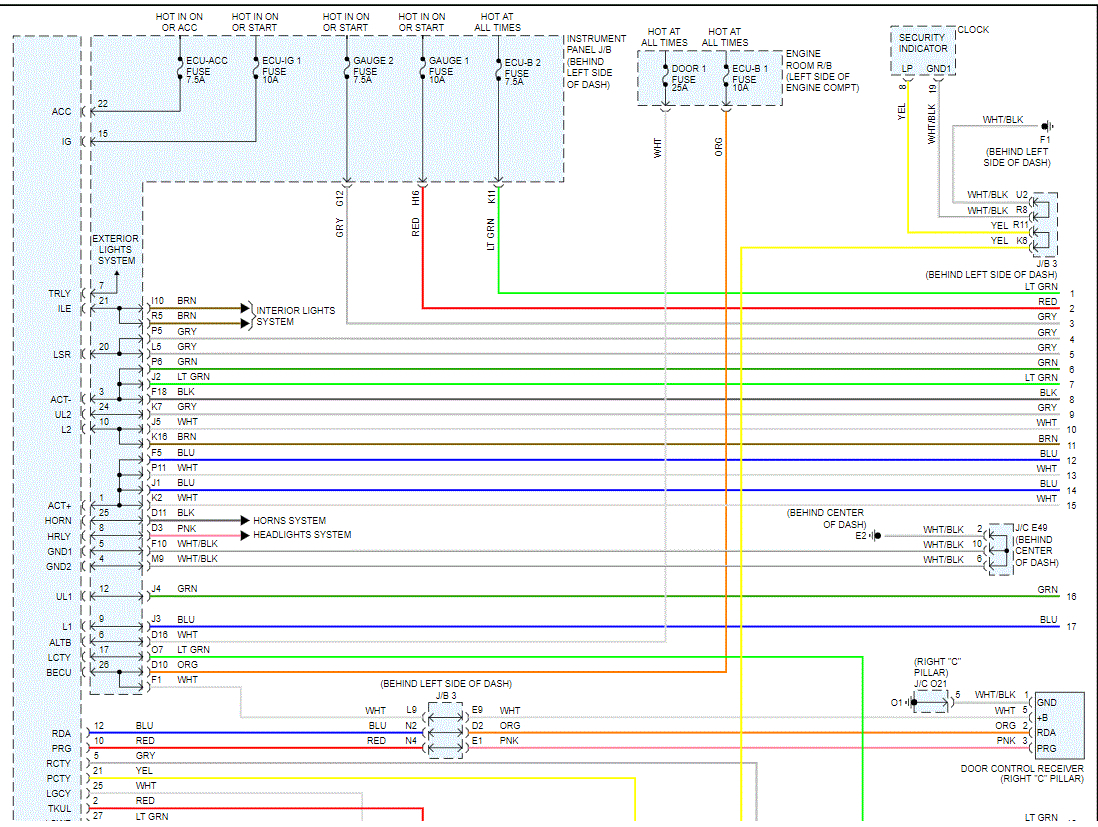

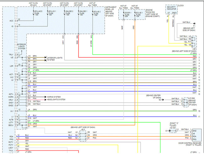

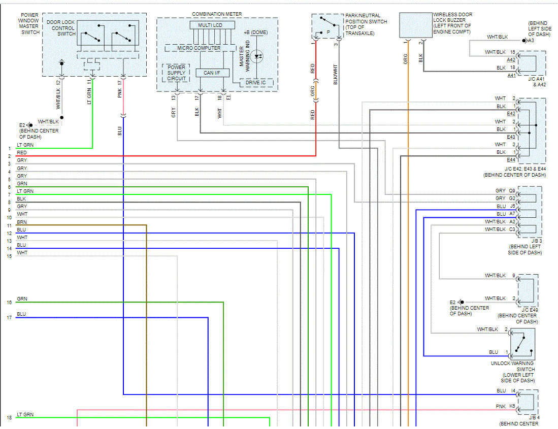

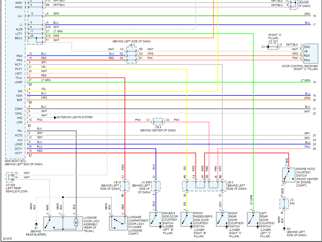

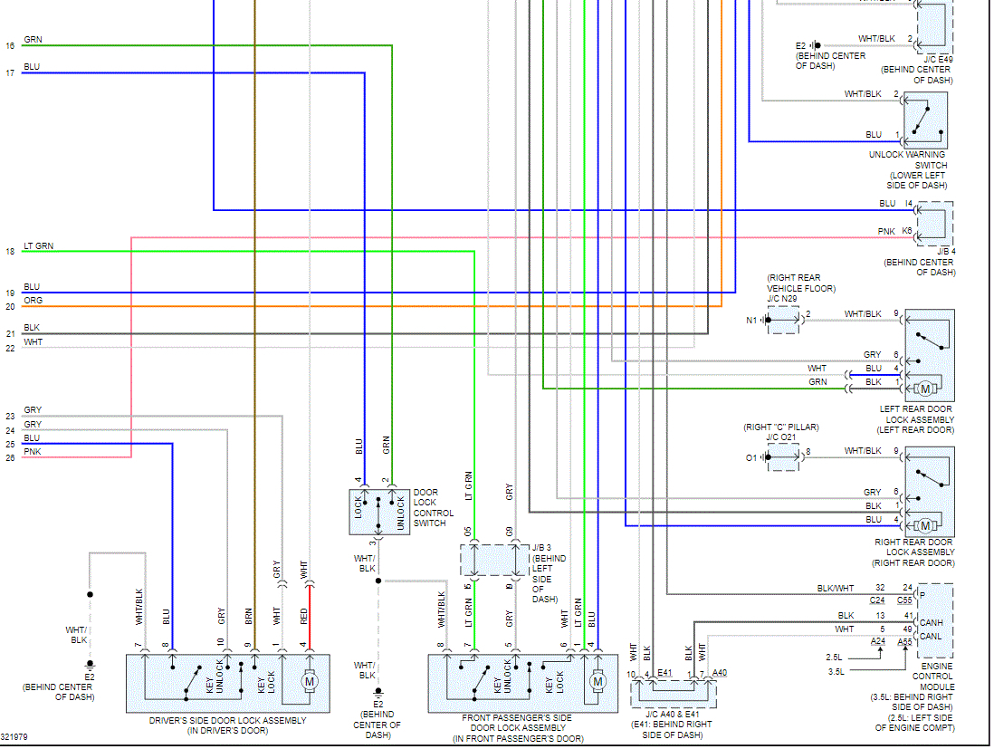

Hi, the vehicle's left door lock do not function sometimes, every other door will lock but this particular one won't lock sometimes. please could you help me with the circuit diagram?
Mar 5, 2021 at 10:12 AM
  • 110,240 POSTS
If it works and then doesn't, there is a good chance the actuator itself is bad.
If you look below, I attached the entire wiring schematics for the door lock system. I had to cut them in half to make them readable, but I did overlap them so you can follow them.
