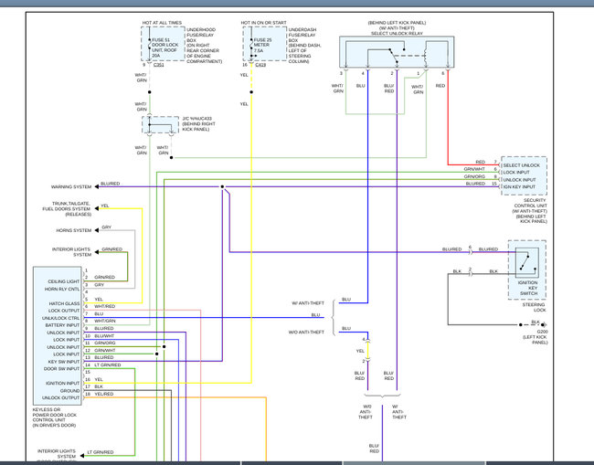

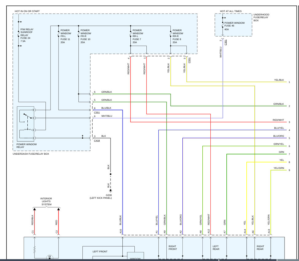

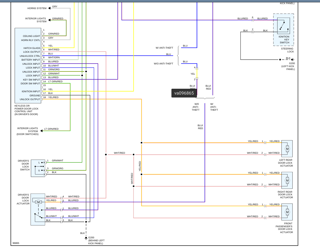

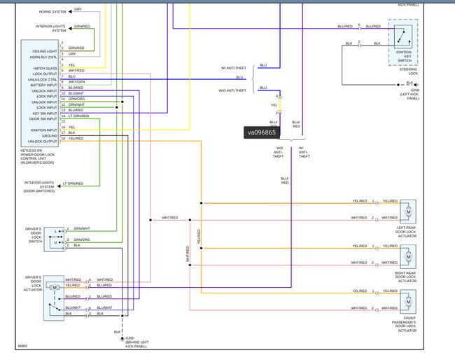

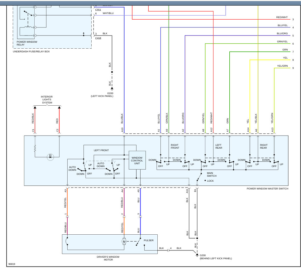

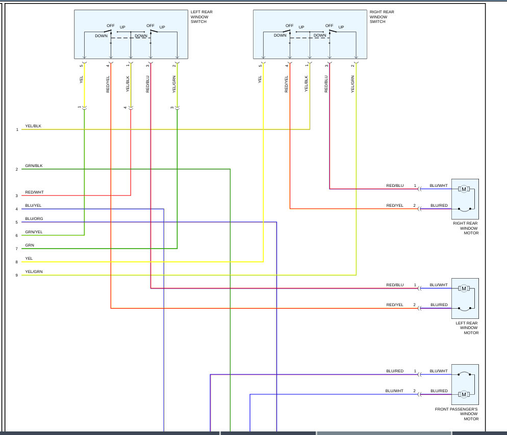

Diagram for the wires on the front passenger door needed
1999 HONDA CRV
200,000 MILES • 4 CYL • 2WD • AUTOMATIC
COLLIN PERRY
Wiring colors from chassis to door female connector coloring order on front passenger passenger side.

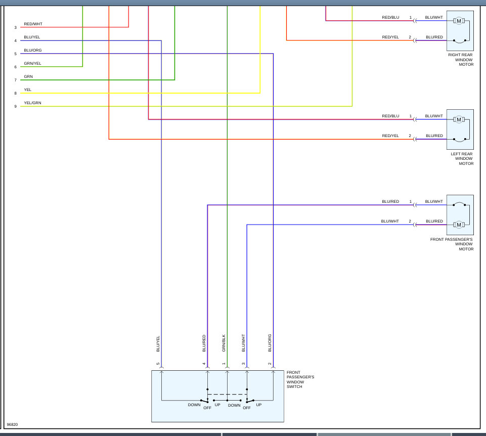

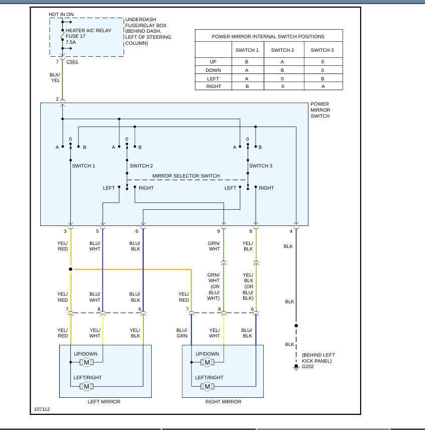

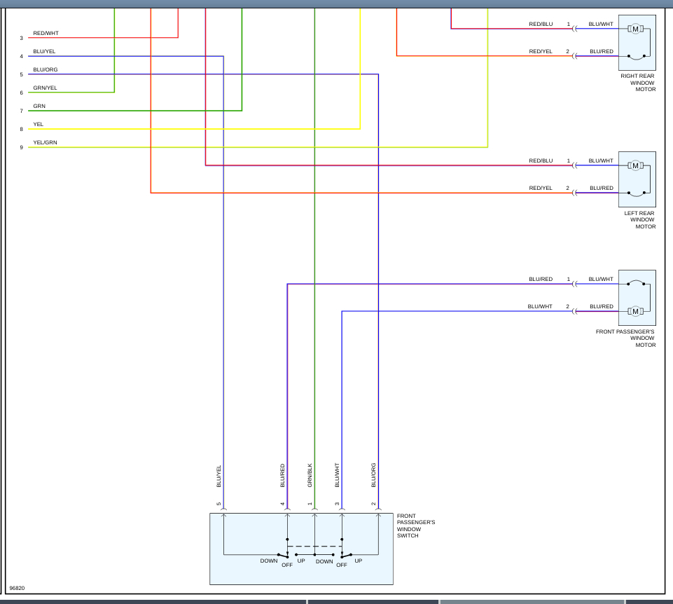

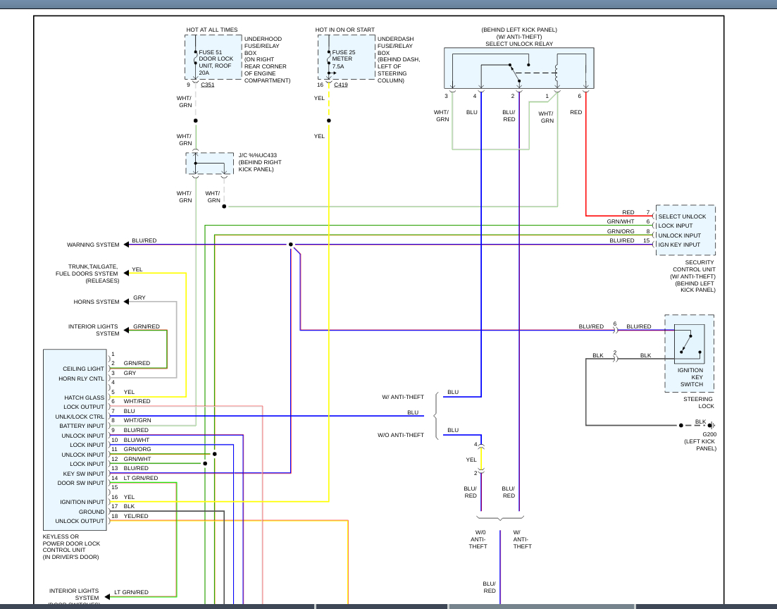

In the diagrams down below I have included the wiring diagrams for the power mirrors,
Power locks and the power windows for your vehicle. I hope that these help. Please go through them and get back to us with how everything turns out.
