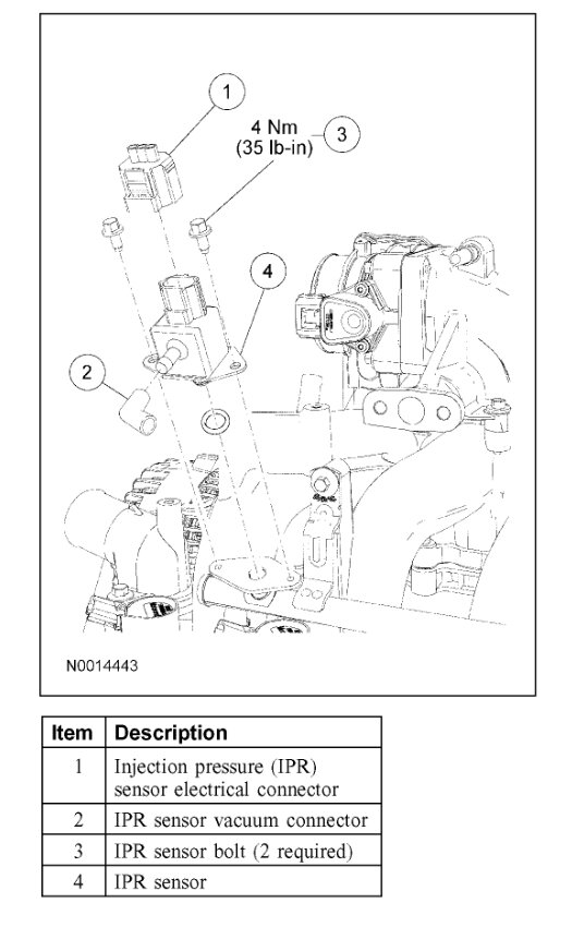

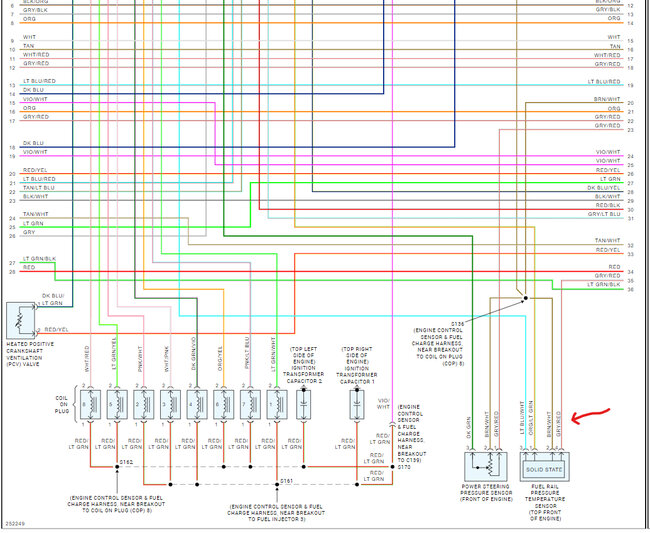

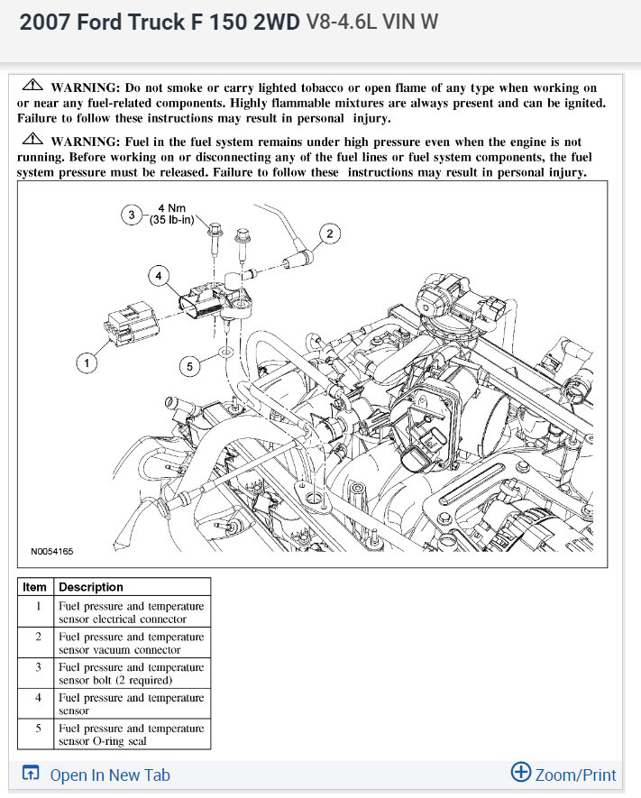

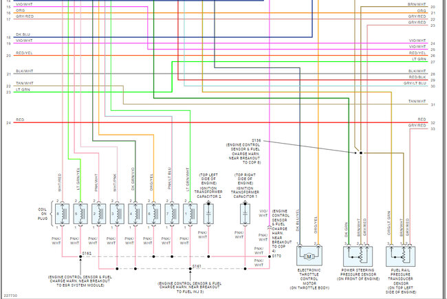

I replaced the engine with a 2006 4.6 engine and my 2007 4.6 engine had 4 wires going to the fuel pressure sensor and the 2006 engine I replaced it with has 3 wires going to the fuel pressure sensor how do I connect the fuel pressure sensors.

Yes, the fuel pressure sensors are different, can you just swap the sensors over to the correct one? There is no good way to wire the different sensors up. Here are the wiring diagrams and I can see a way of doing it to were you won't get a check engine light on. Check out the images (below). Please let us know what happens.
