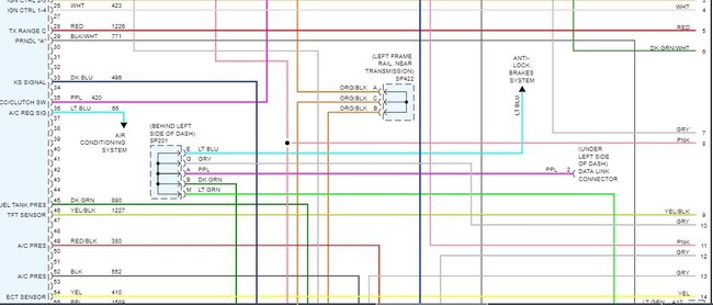

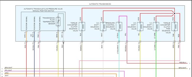

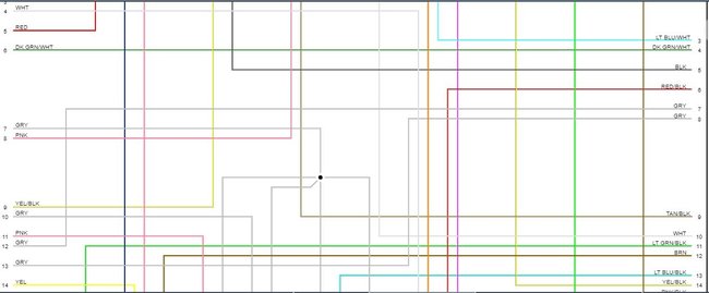

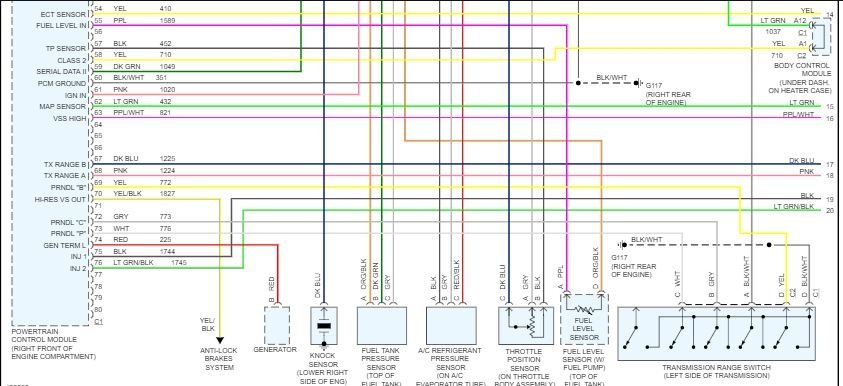

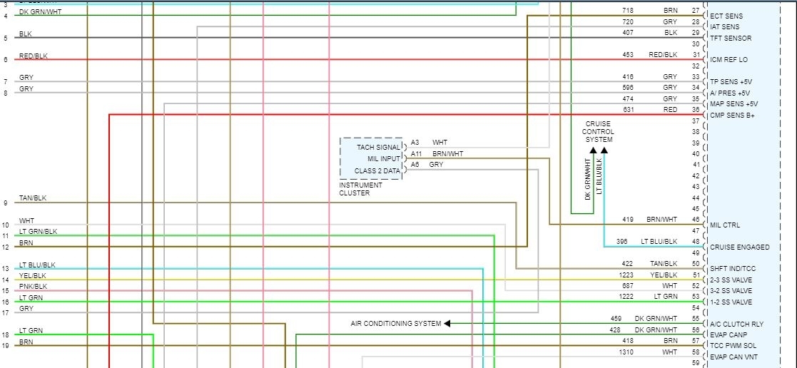

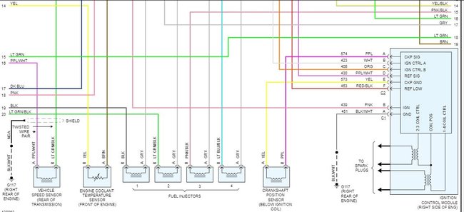

Cranks will not start wiring diagram needed
2000 ISUZU HOMBRE
150,000 MILES • 2.2L • 4 CYL • 2WD • AUTOMATIC
DOVERDOG

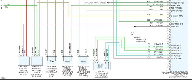

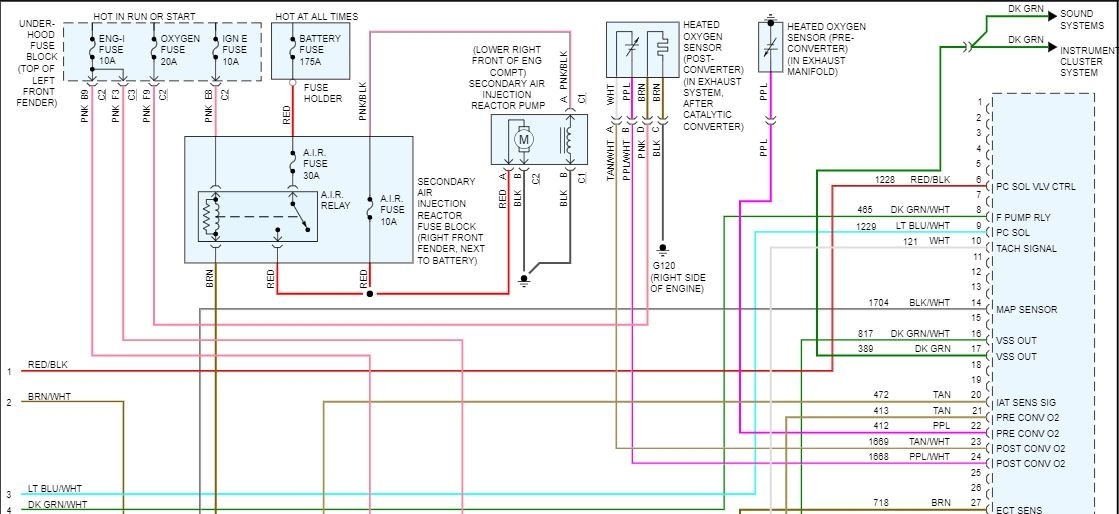

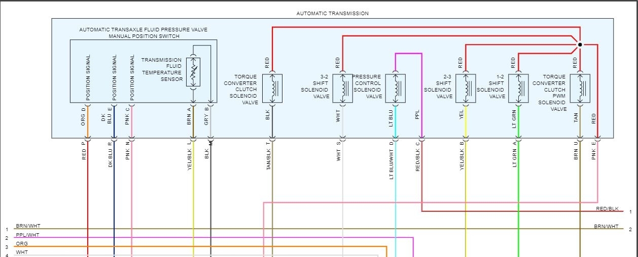

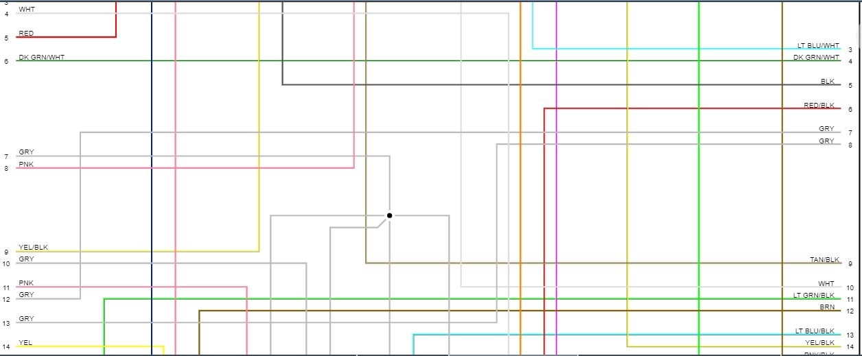

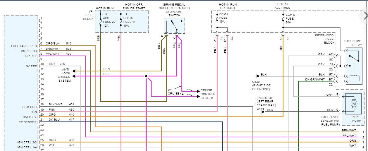

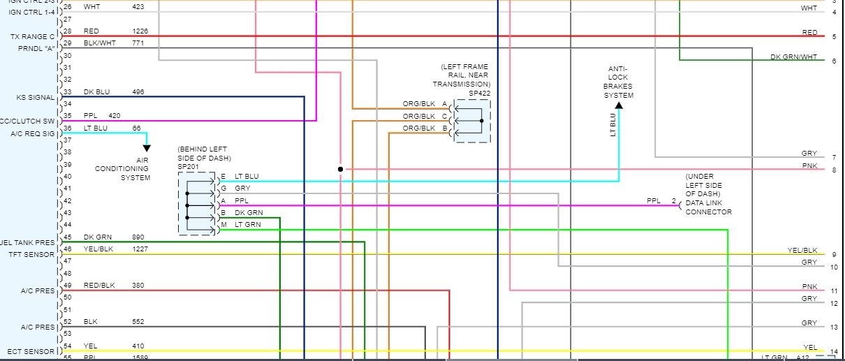

I need a reining diagram for this truck. engine turns over fine but won't start. has a new fuel pump. but i need to chase the wires to test. please help
Aug 20, 2019 at 9:17 AM
  • 110,240 POSTS
Welcome to 2CarPros.
I am going to provide all of the wiring schematics for the engine controls. There are several pages to this. I will need to cut the pages into three parts to make it readable for you. I will overlap them so you can follow from one to the next.
If there is another area you need schematics for, let me know.
I hope this helps.
