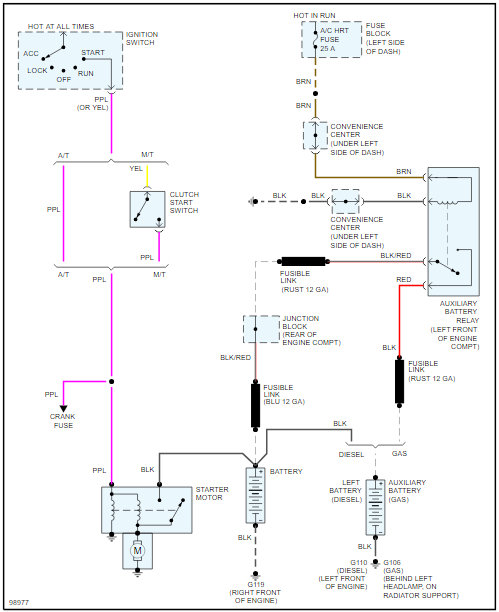

All the wires got cut and i am having to splice them back together i need a color diagram of the wires under the hood.

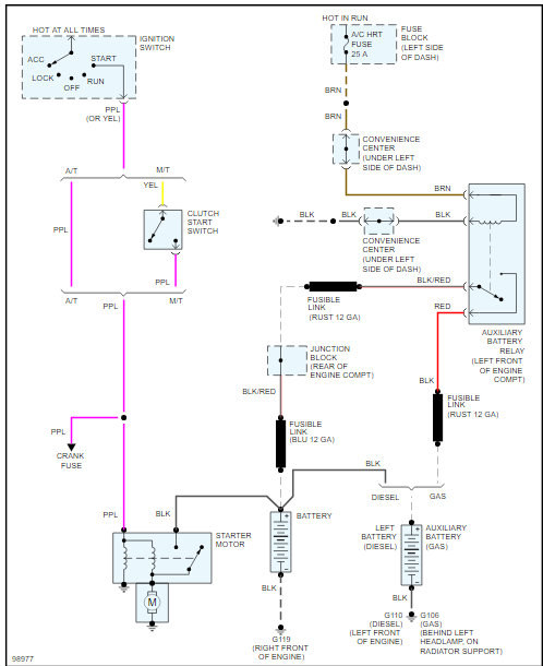

I've attached 2 pictures below of the starting and charging system to begin with. Let me know what other components you need diagrams for. My 1989 K1500 has 79,000 original miles.Hope this helps and thanks for using 2CarPros.
