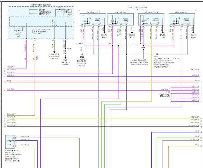

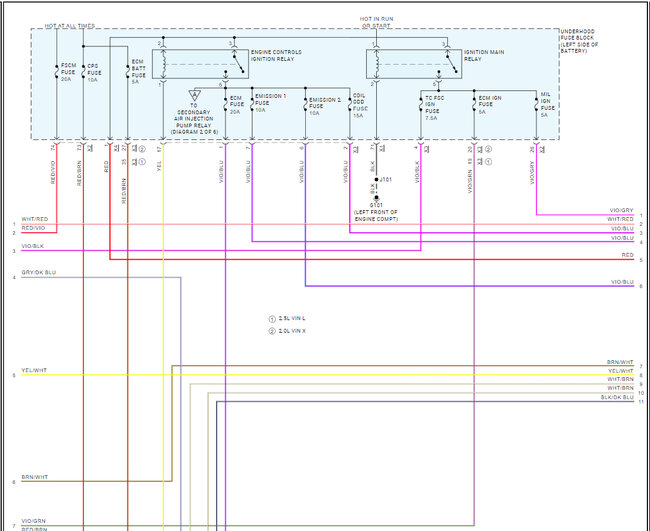

Can I get the engine wire(s) diagram(s) and schematics?
2014 CHEVROLET MALIBU
120,000 MILES • 2.0L • 4 CYL • TURBO • 2WD • AUTOMATIC
JAKNIYAH
  • 31 POSTS
Where can I find the engine wire(s) diagram(s) and schematics for the car listed above with a 2.0l l4 turbo? Any book or site that can tell me about each wire set up and function in the car's engine.
Aug 1, 2024 at 2:44 PM
  • 55,433 POSTS

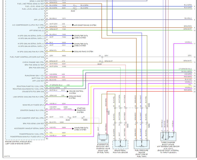

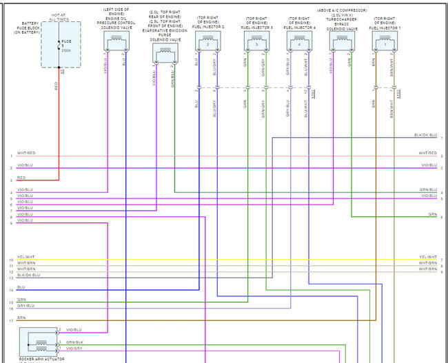

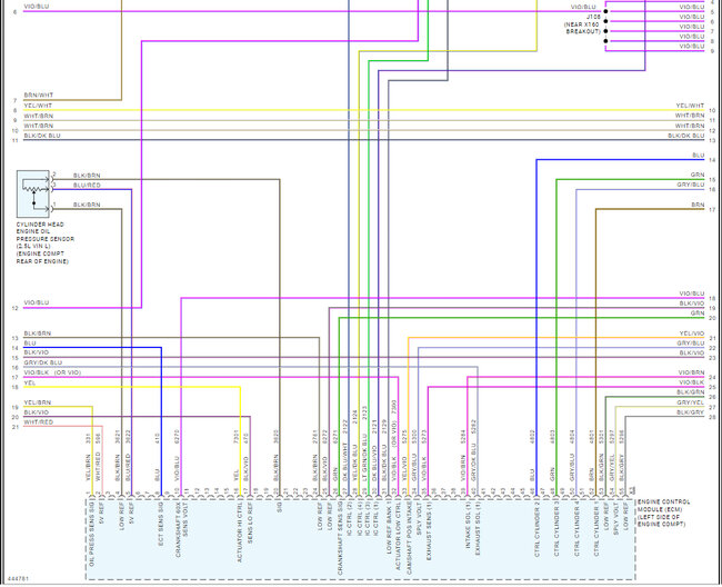

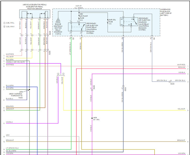

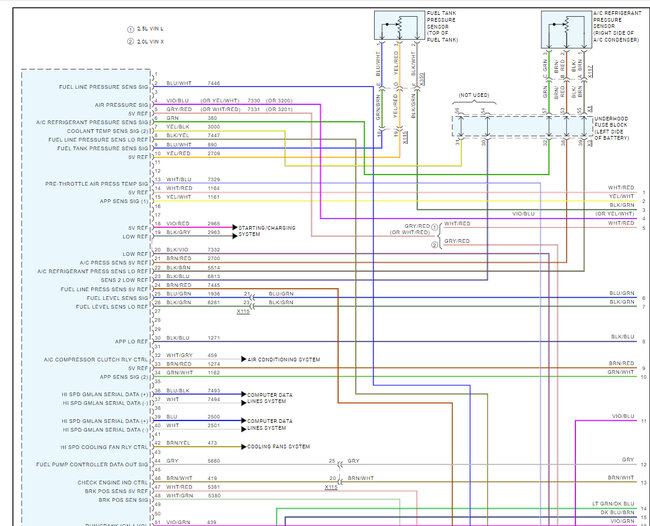

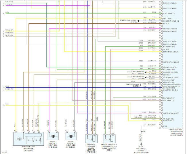

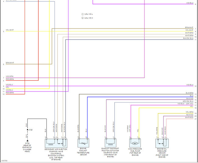

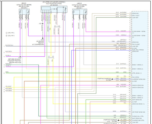

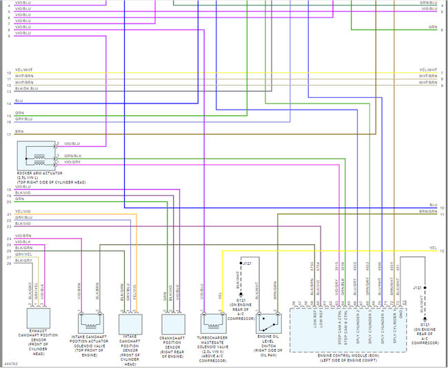

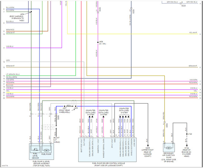

Sure, here is a guide to help you test the wiring and I have included the engine wiring diagrams in the images below:
Check out the images (below). Let us know if you need anything else.
