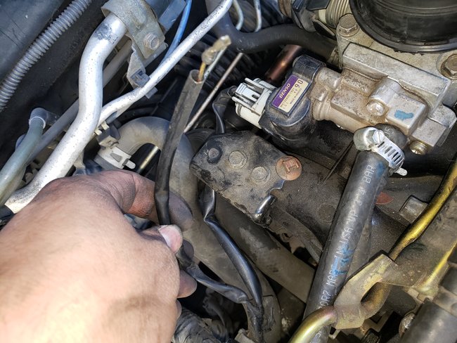

I can not identify this wire.
I purchased this vehicle second hand and recently found this cable tucked near the intake manifold underneath the throttle body.
It shares a loom with the wiring for the IACV .
Can anyone identify it for me?
This is the 2001 non-EGR LX version 1.7L.
A diagram would also be appreciated.

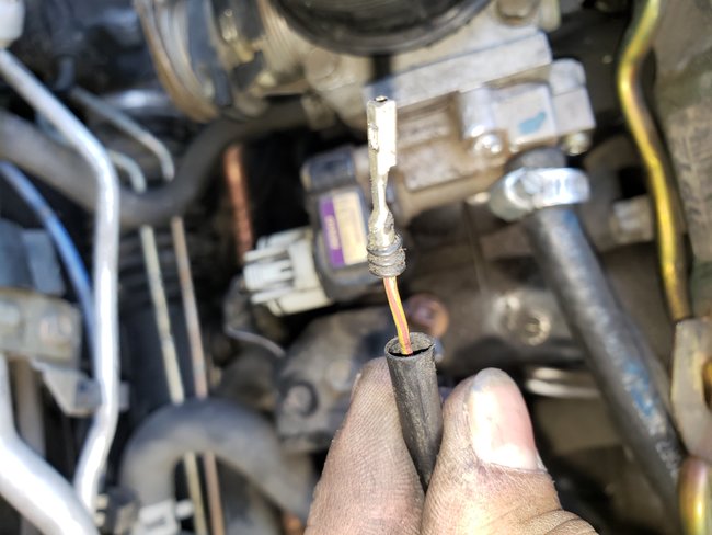

Here is a picture of the cable I mentioned:
Jan 22, 2020 at 3:30 AM
BUSINESSFRED
  • 96 POSTS
Here is a more clear picture.
It is red/yellow.

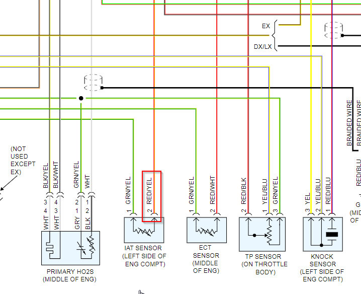

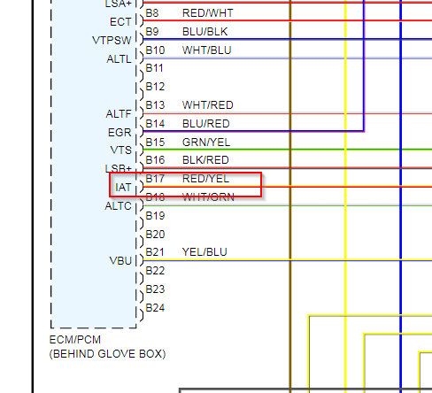

Looks like the red/yellow wire is for the intake air temp sensor. I included the diagram from the IAT to the PCM.
Let me know if you need more info or anything else. Thanks

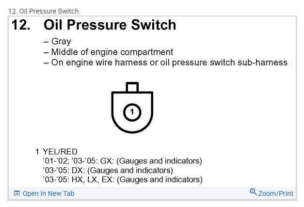

The IAT is on the driver side of my vehicle and the connector is attached. I think that it may be the oil pressure sensor because I found the connector missing and a portion of the sensor missing .
Jan 23, 2020 at 11:30 AM
Well that would make sense because looking at that wire again, it is actually a yellow wire with a red tracer. Unfortunately that makes a difference because the red wire with yellow tracer (red/yellow) is for the IAT.
Looks like you found it anyway. Well done. Let us know if you need more info.
