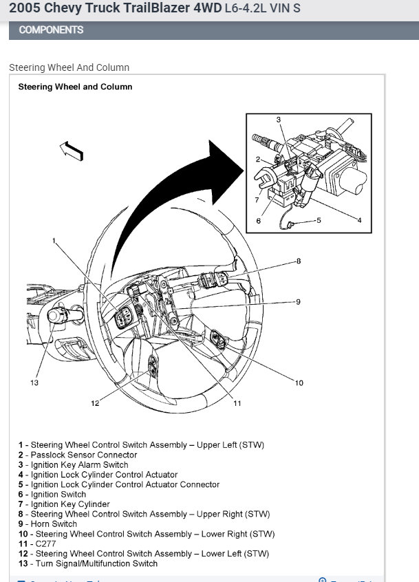

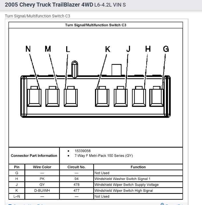

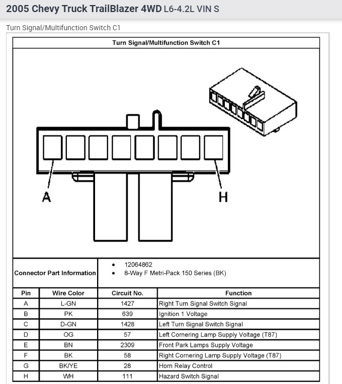

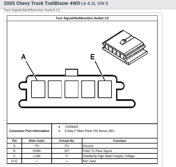

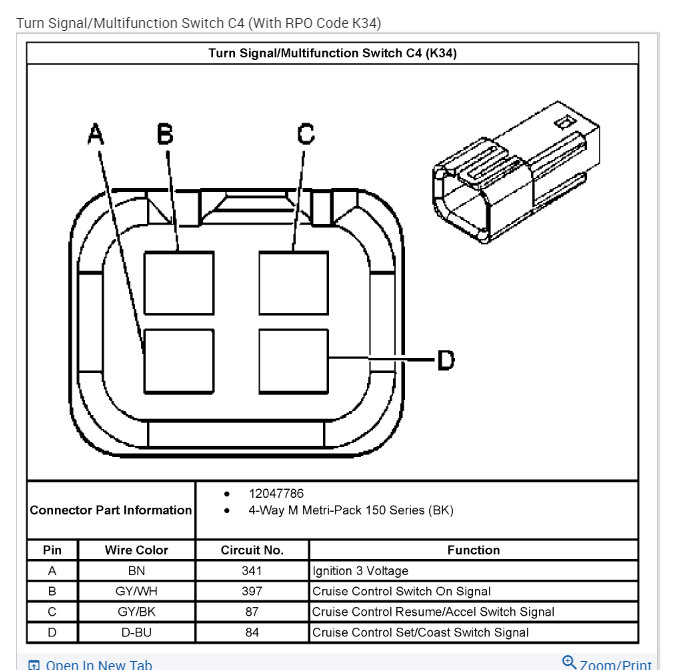

wire harness turn signal, hazard pinout needed
2004 CHEVROLET S-10
150,000 MILES • 3.4L • 6 CYL • 2WD • AUTOMATIC
TRADITUR DAVIS
Replaced steering column and turn signal harness used a 2005 Trailblazer in a 2004 s10 blazer looking for a pinout for the Trailblazer to get the lights to work.
Oct 16, 2021 at 9:15 AM
SQM
  • 6,383 POSTS
See attached for the multifunction switch pinout on the 2005 Trailblazer.
Oct 16, 2021 at 10:29 AM
