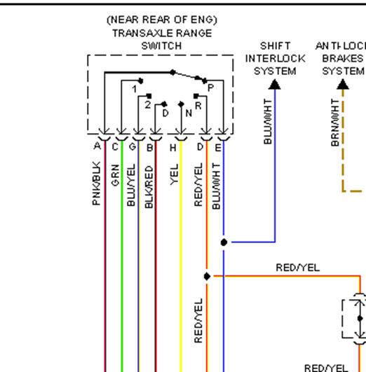

rat ate thru wires coming from harness to tranny........causeing hard shift from 1st to 2nd.......wires were compromised right at connectors WHERE 3 WIRES GO TO 2 !!!!!!!!!???? one of the 3 (coming from harness) is uninsulated..........should i include it in splice---i think i know which one of two it would have been with?????

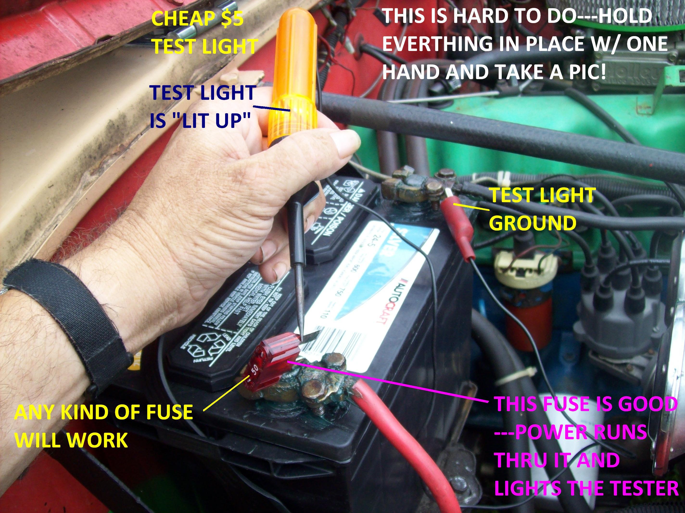

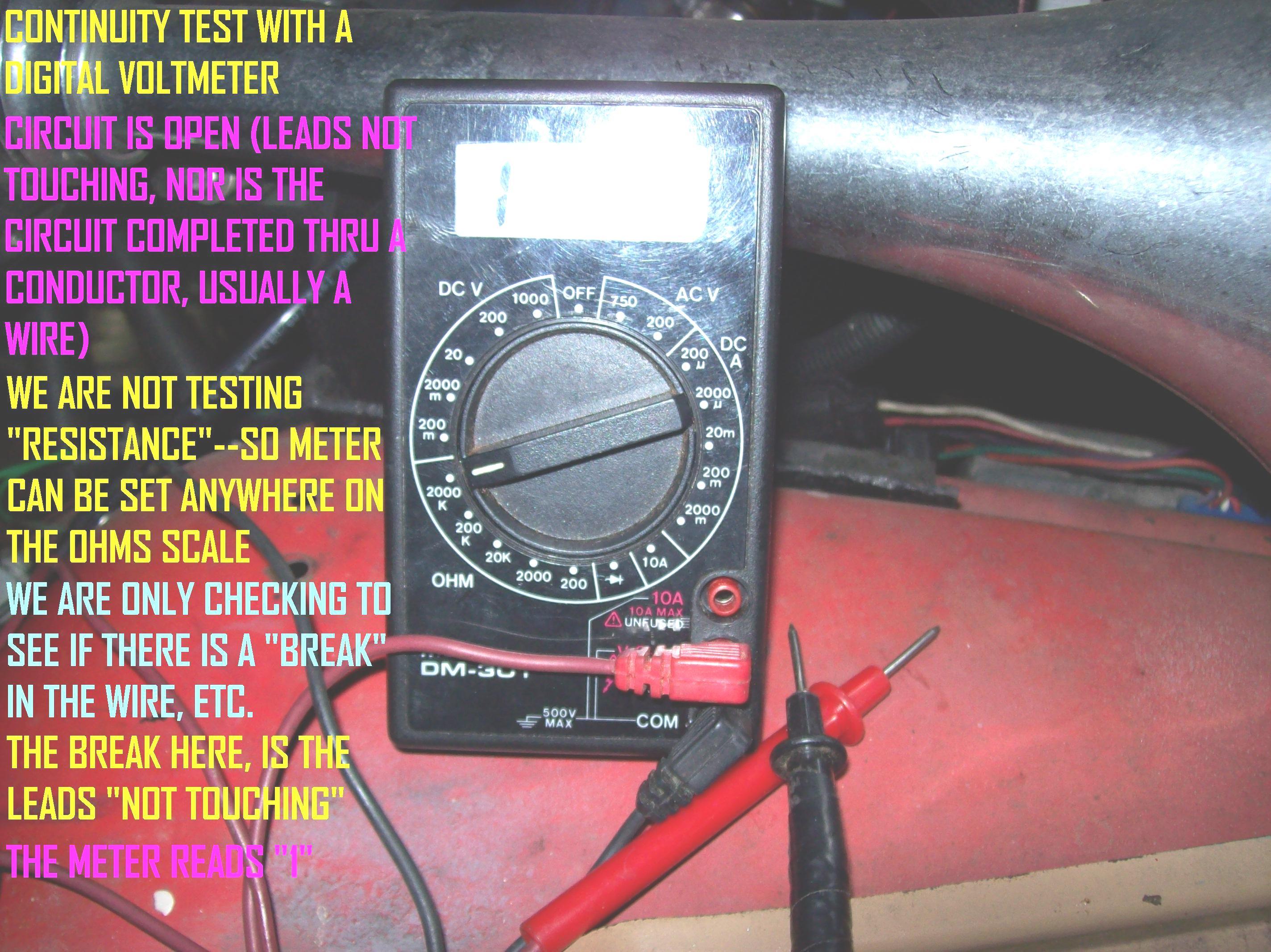

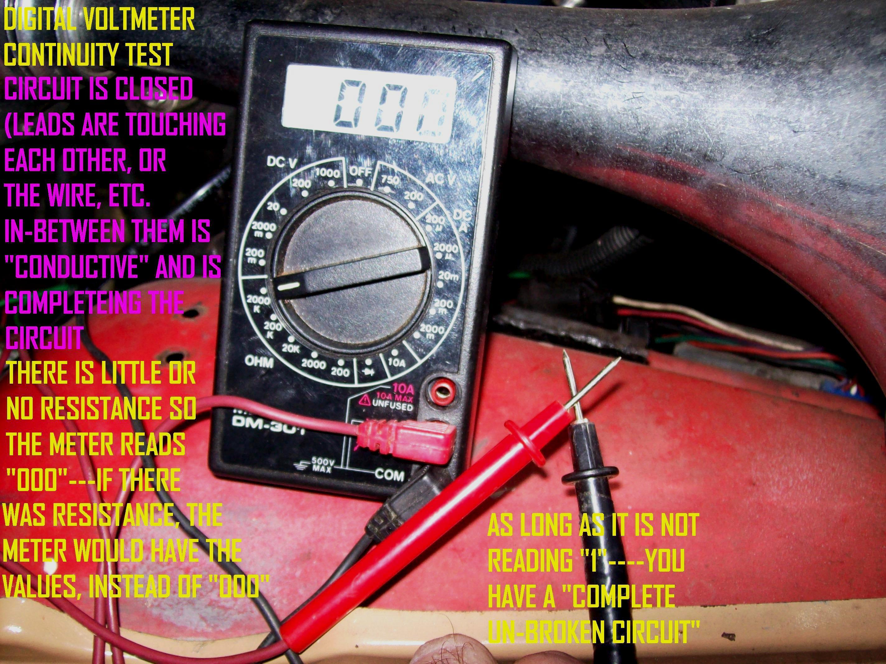

IF YOU WANNA KNOW IF 2 CONNECT TOGETHER IN THE CONNECTOR
RUN A CONTINUITY TEST FROM THE "2 SIDE" TO THE "3 SIDE"
"HARBOR FRIEGHT" HAS DIGITAL VOLTMETERS STARTING AT $5-AUTO PARTS STORES ABOUT $20................A 12 VOLT TEST LIGHT $3-$20
I'VE USED A FLASHLIGHT---TURN ON THE FLASHLIGHT, REMOVE THE TAIL END, USE JUMPER WIRES FROM THE BODY---ANOTHER TO THE END OF THE BATTERY---------TOUCHING THE JUMPERS TOGETHER WILL LIGHT UP THE LIGHT.........TOUCHING THEM TO EITHER END OF SOMETHING CONDUCTIVE.....WILL TURN IT ON TOO
WAH-LAH! INSTANT AND CHEAP CONTINUITY TESTER!
GIVIN' YOU 3 HOMEMADE PICS OF HOW YOU CAN DO THIS......SORRY, DON'T HAVE ONE FOR THE FLASHLIGHT........IF YOU WANT, I CAN MAKE ONE....I AIN'T SKEERED!
LEMME KNOW HOW IT GOES

not sure what cont test would tell mee......................anyway i put it together and followed my instinct and paired the bare wire with one of the two---------problem solved.......................thanks for your input!

SORTA THOUGHT IT WOULD TELL YOU IF THE 3 WERE SEPARATE AND ONE WAS UNUSED
OR WHICH 2 HAD THE SAME CONTINUITY TO WHICH PIN ON THE OTHER SIDE
OH WELL........GLAD YOU GOT IT FIXED!

HMAC300
  • 48,601 POSTS
if this is the correct one in pic this is how it goes if not give me the wire colors and i'll send the correct ones
