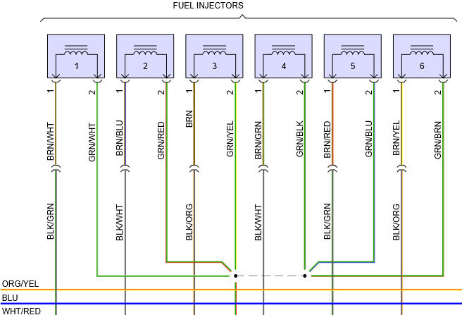

Need to know where the wire harness sits in the car. I got the part from the dealership and I think there is a color code for it one side is grey the other side is black. please can someone help? thank you.

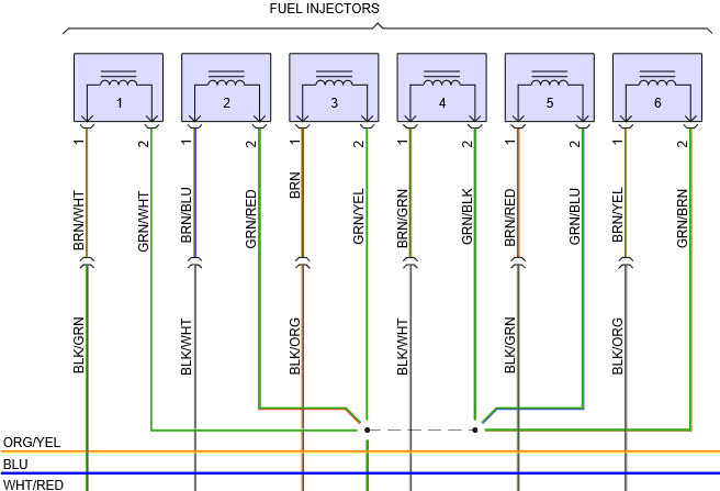

they are all different colors see pictures. most are gray brown black etc. The intake has to be removed to replace them they will only go on one way.

Here are the color codes. Now you do realize that you have to remove both the upper intake and the fuel rail to do this. https://www.2carpros.com/images/external/104415182.gif
