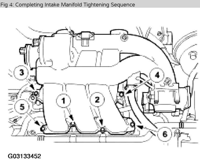

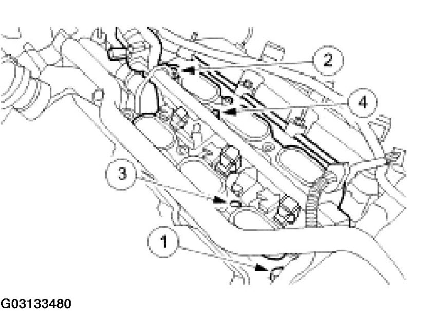

Torque specifications for lower intake manifold and upper intake manifold. thanks guys, I appreciate it.

lower intake is 10 Nm upper is 10 Nm, but do not tighten until all brackets have been installed. Both must be tightened in sequence. see pictures.
