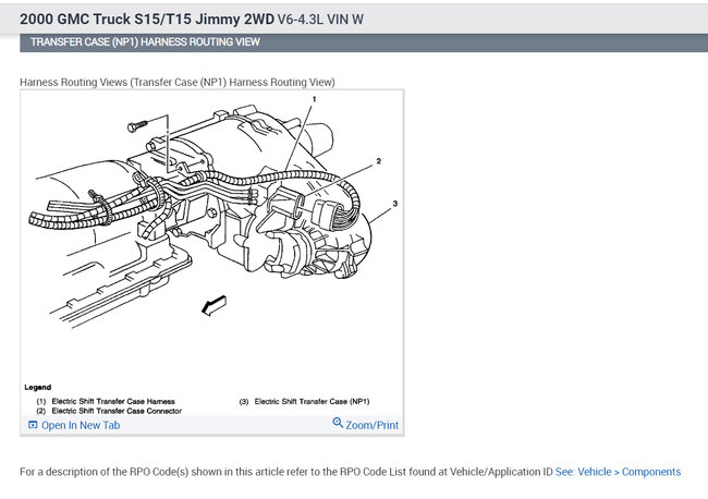

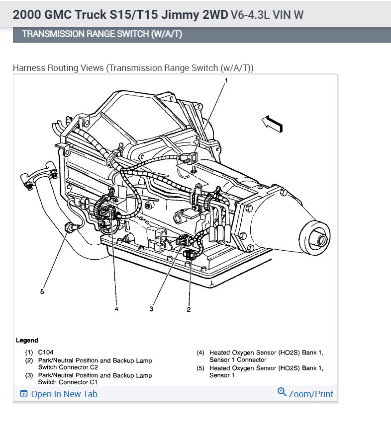

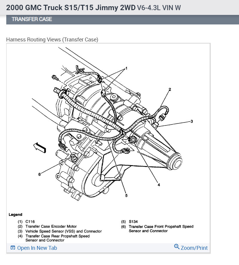

Can I get a guide with pictures for where every plug and wire connect properly from the headlights to the transfer case?
2000 GMC JIMMY
70,000 MILES
BILLGILL707
Paid someone to do a motor swap on my vehicle listed above, I need a guide with pictures for where every plug and wire connect properly from the headlights to the transfer case.
Jan 26, 2023 at 3:48 AM
  • 55,423 POSTS

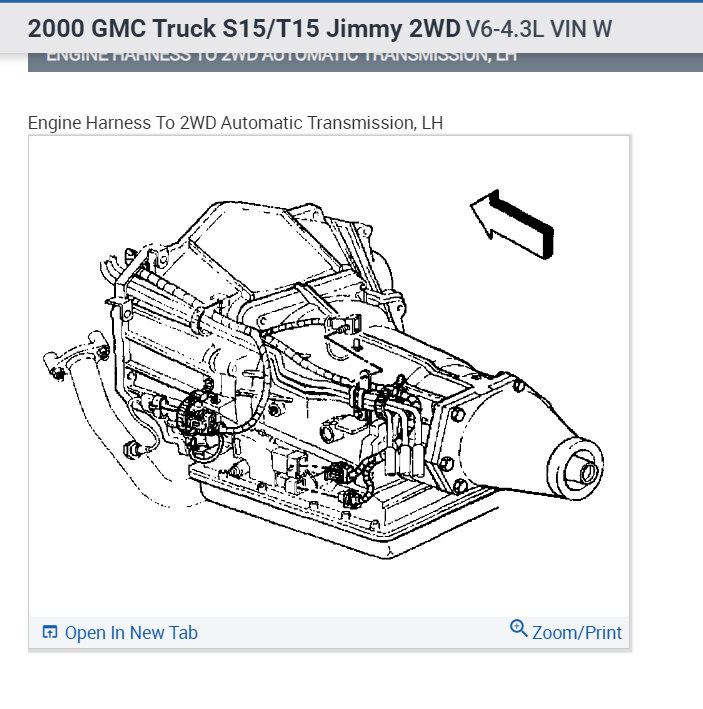

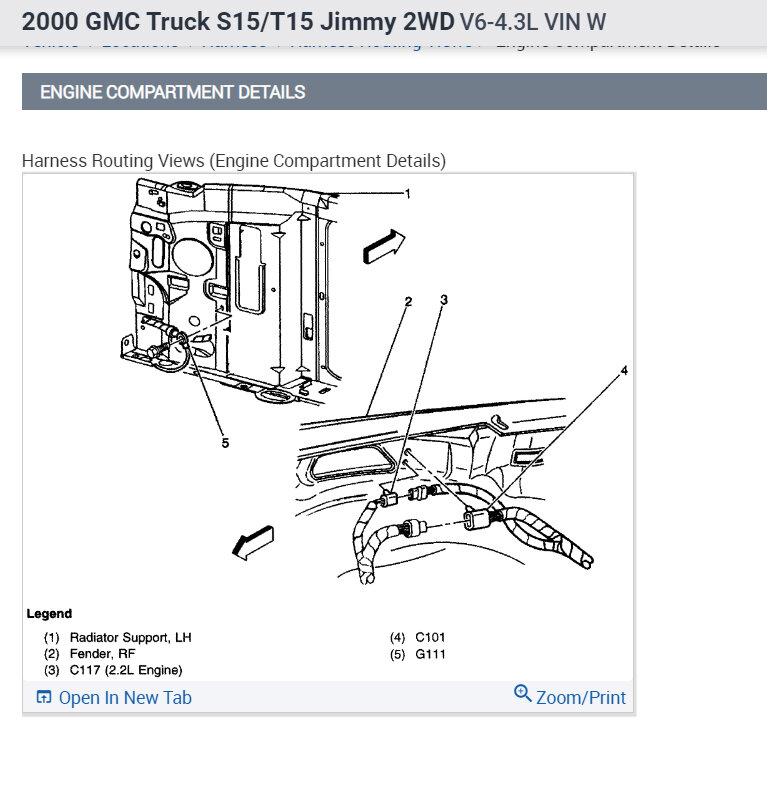

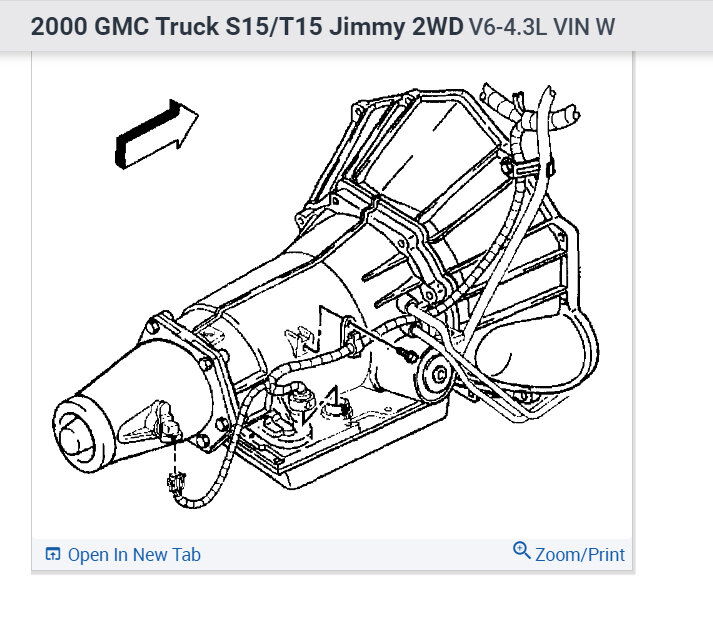

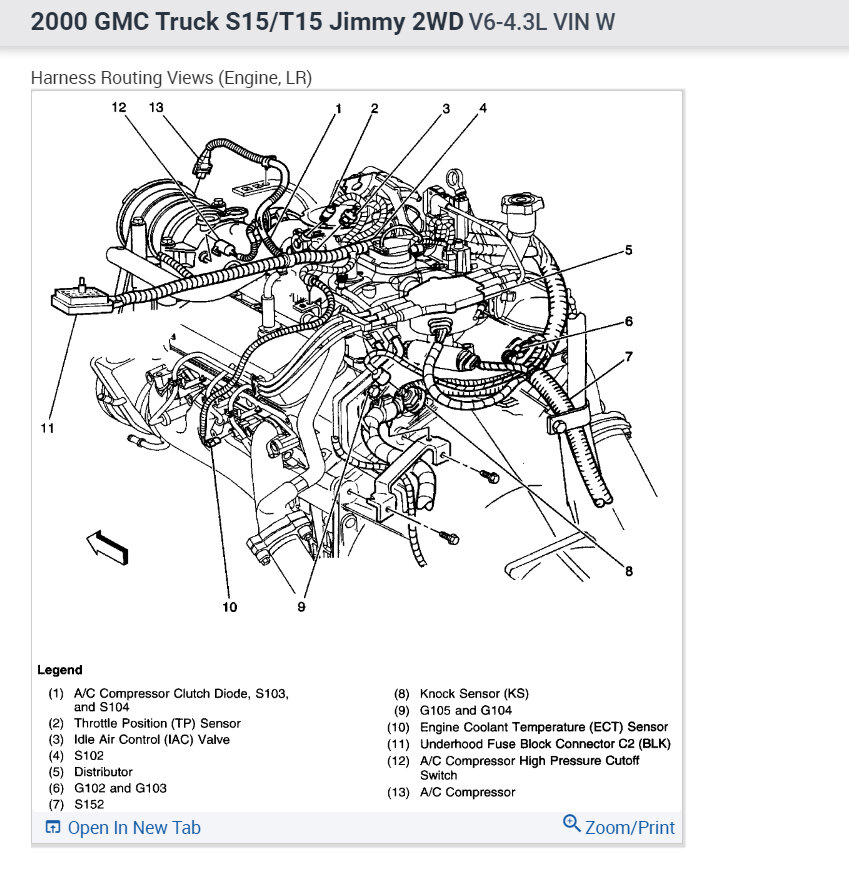

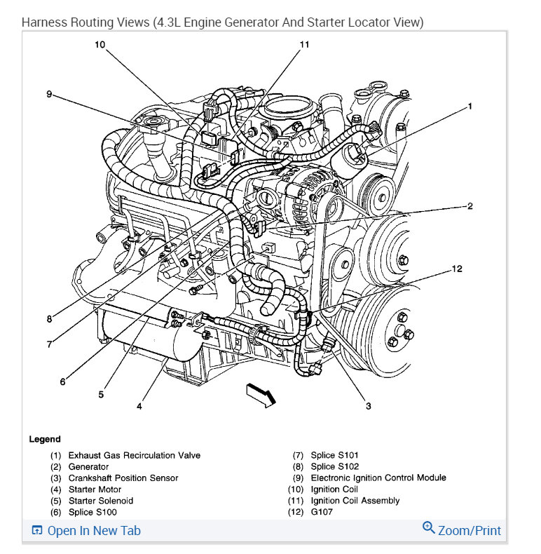

Sure, here you go this shows the engine, transmission and transfer case wiring connectors and where they go. Check out the images (below). Let us know what happens and please upload pictures or videos of the problem.
Jan 27, 2023 at 4:03 AM
BILLGILL707
Mine is a 4x4 is there gonna be much if any difference? I see that the first couple diagrams show for a 2wd jimmy. Thank you for your help so far
Jan 29, 2023 at 1:56 AM
  • 55,423 POSTS
It is the same, the 2wd title must be a misprint.
