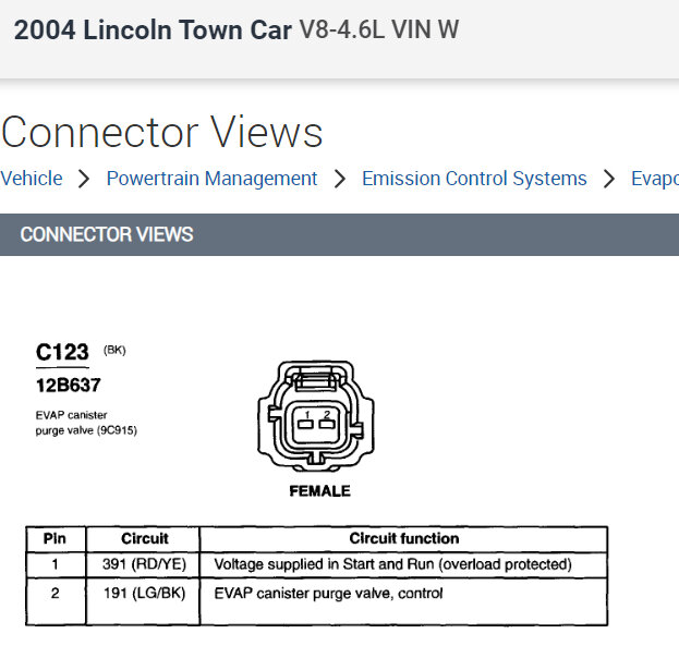

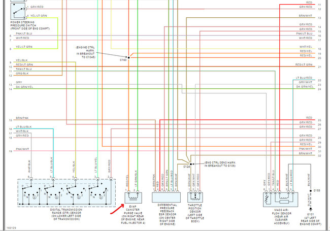

Changed fuel pump assembly. I have to cut and splice wires for purge valve. Wiring on the car has three wires, red, brown with red tracer and brown with white tracer.
New fuel pump assembly has three wires, red, black, blue. Which ones should be connected to which? I am assuming red to red, but the others I don’t know.

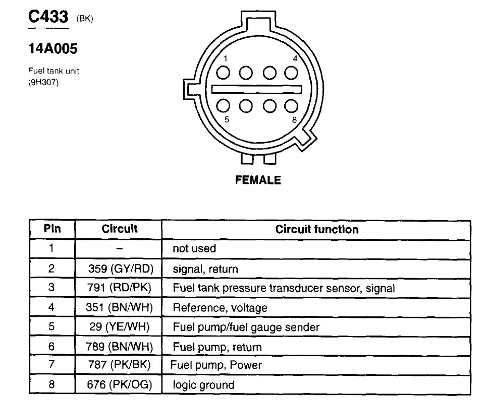

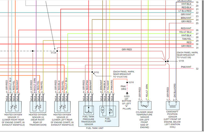

Sure, here are the wiring diagrams for the canister purge valve and the fuel pump with the connector views, check out the images (below). Let us know if you need anything else.

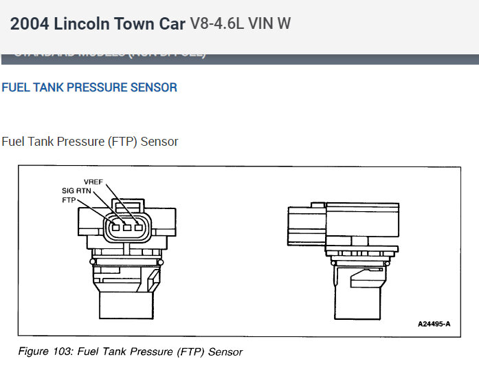

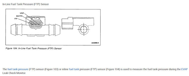

Thanks for the reply. To clarify I am talking about the sensor on top of the fuel tank, accessible via the right rear wheel well. (Fuel tank Pressure transducer? As seen in your last image) I thought it was called a purge valve. In any case the wire colors are different from my new pump. Thanks in advance for your input.

If the gauge is not working, you will get this message. I would double check the wiring and make sure the connector wiring is in the correct order. I think you are talking about the fuel tank pressure sensor? here is what they look like. Check out the images (below). Please let us know what happens.

Yes, I did see the diagrams, thanks for that. But I still don’t know which wires would connect to each other. I’m assuming red to red, but the other two???
Oct 23, 2024 at 5:26 AM
  • 55,433 POSTS
Black should be the ground which is pnk/org wire. So the fuel pump only has three wires? There need to be four because of the fuel pump control module. I would get the correct pump for it.
