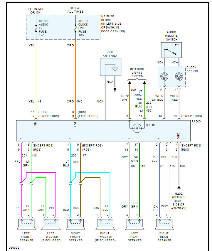

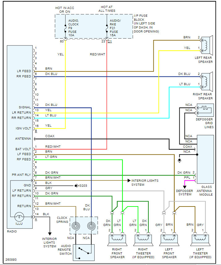

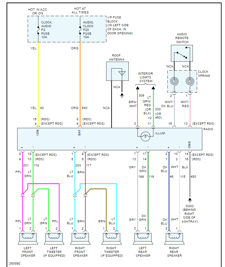

I'm trying to hook up my system to the factory deck and I need help with the wire diagram for the factory stereo.
Feb 23, 2024 at 2:31 AM
  • 55,421 POSTS
Sure, there are two different options depending on body style I have provided both radio wiring diagrams. Let me know if you need anything else and check out the images below.
