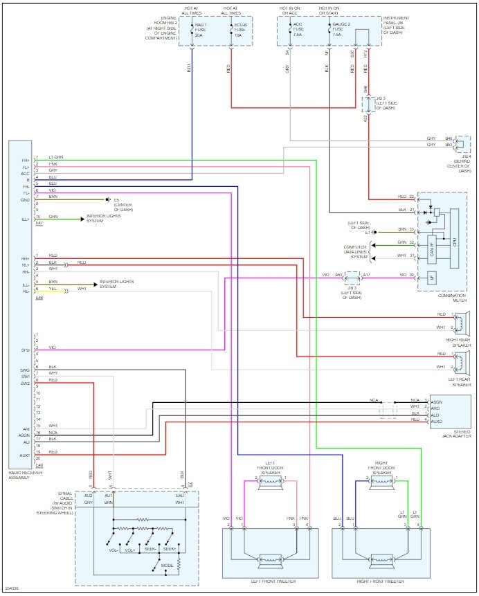

Does your Rav4 have a factory JBL stereo or just standard?
There's a couple of options... I will include both.

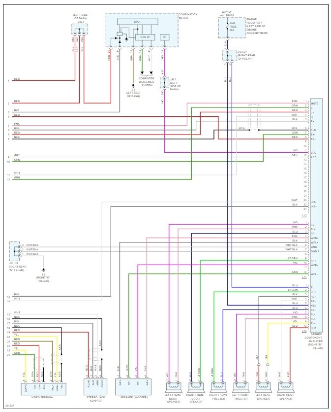

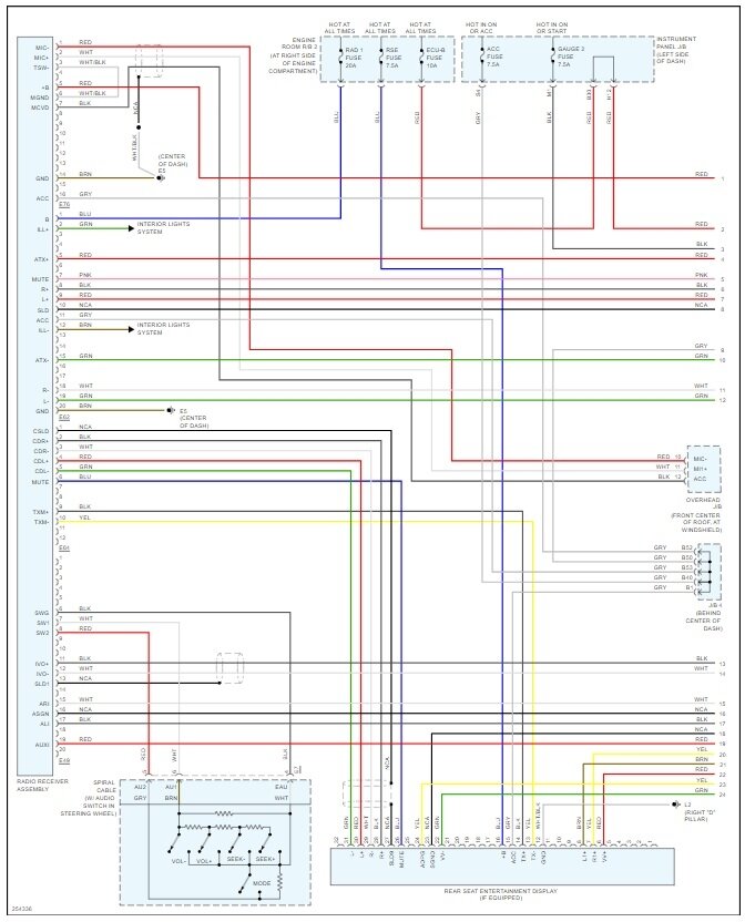

more diagrams... these are if your truck has the JBL system... it's tied in with a few more things.
