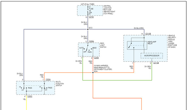

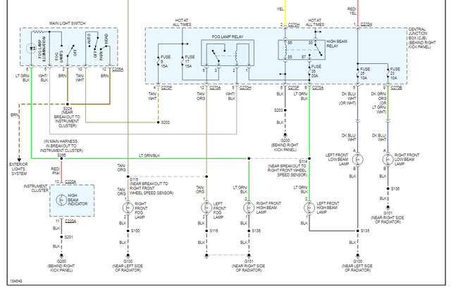

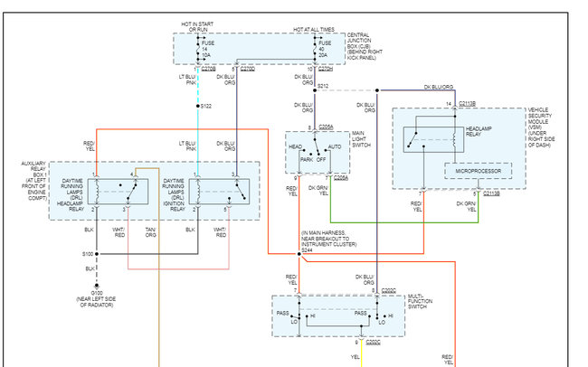

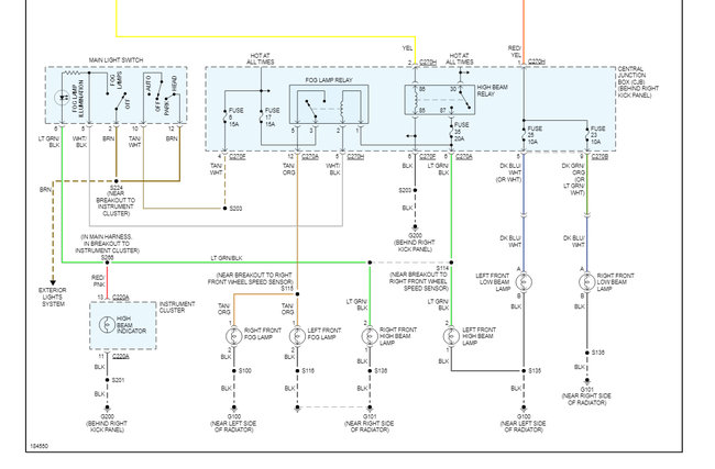

Front passenger side low beam not working, replaced bulb. Still nothing checked fuse nothing. Rear passenger turn signal has no power to bulb. not sure if inline fuse or broken wire. low beam possible a motherboard inside light problem. i don't have a wiring schematic to go by. Need one.
Sep 9, 2022 at 5:59 AM
SQM
  • 6,383 POSTS
See attached for the wiring schematics. I have attached both with and without DRL schematics.
