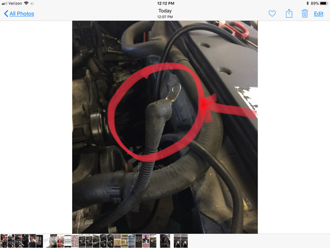

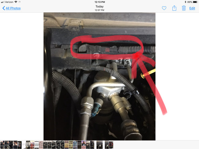

I did not take a pre picture of this before I took it off replacing my head gaskets. This is the only one I cannot remember where it goes. Could you help me, please? Thanks

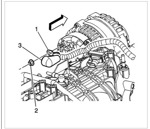

Do you have anything plugged up to the alternator b+?
It looks like this.

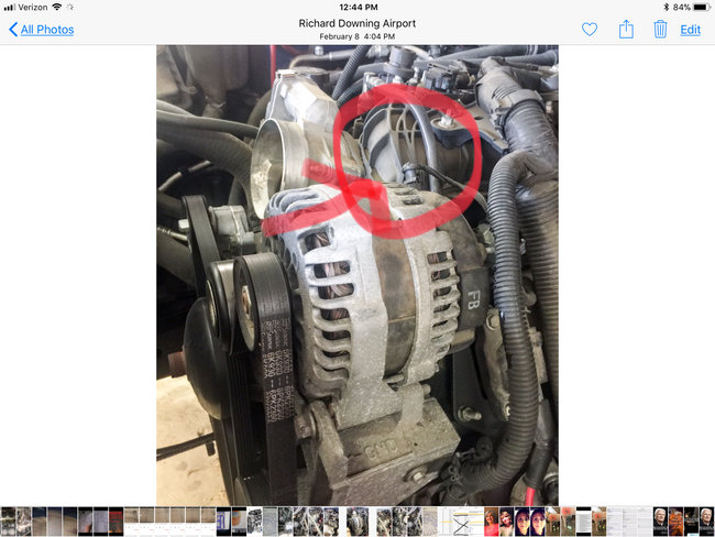

I have a plug that goes on the alternator. Picture attached.

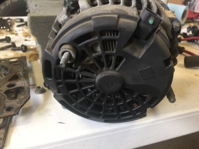

I think those are the field wires, is there anything hooked to the B+, Take a photo of the back of the alternator.

No Sir, that is where it goes. Thanks!
Mar 12, 2018 at 3:09 AM
PATENTED_REPAIR_PRO
  • 1,853 POSTS
It looks like you are also missing an insulator for that b+ stud because it cannot be allowed to contact that alternator casing.
