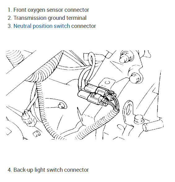

There looks to be a grounding wire coming from the fire wall and I am not sure where it goes?
2001 SUBARU LEGACY
200,000 MILES
BASHWHEELS
It is between the master cylinder and the brake booster. I am finishing up replacing the clutch and unfortunately, I should have paid better attention when taking everything apart. Also, there is a ground wire for the transmission. Where exactly do I mount that on the transmission?

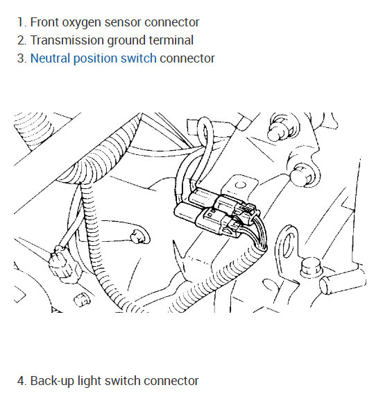

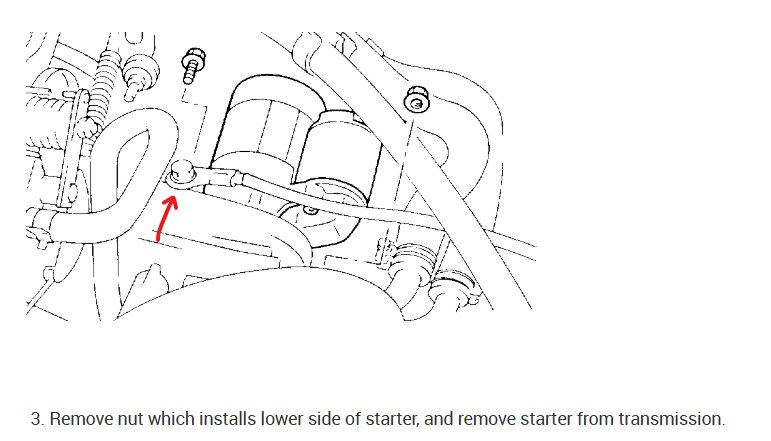

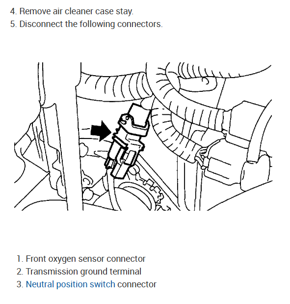

There are ground wires from the battery to the engine or transmission, there should be a ground wire going from the transmission to the firewall. Here are the locations for the ground connection and other wiring connectors as well. Check out the images (below). Please upload pictures or videos in your response of any problems so we can see what to help you with.
