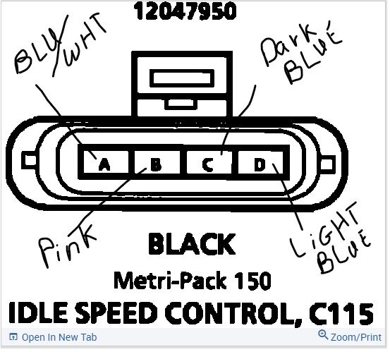

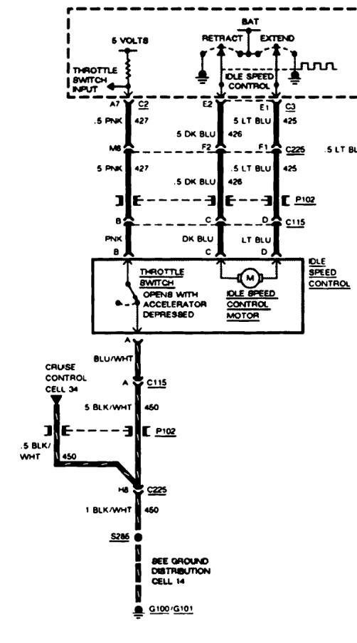

The air idle control valve wires got cut into and having to wire back up what colors go to what color.
Mar 15, 2023 at 4:02 PM
STEVE W.
  • 15,413 POSTS
The IAC has a 4-pin connector with a pink wire (5-volt bias), a light blue wire (motor), a blue wire with white stripe (ground) and a dark blue wire (motor). The connector view is looking at the front face of the connector on the wire.
