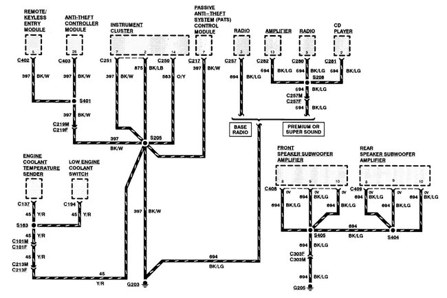

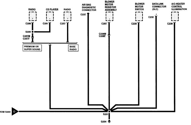

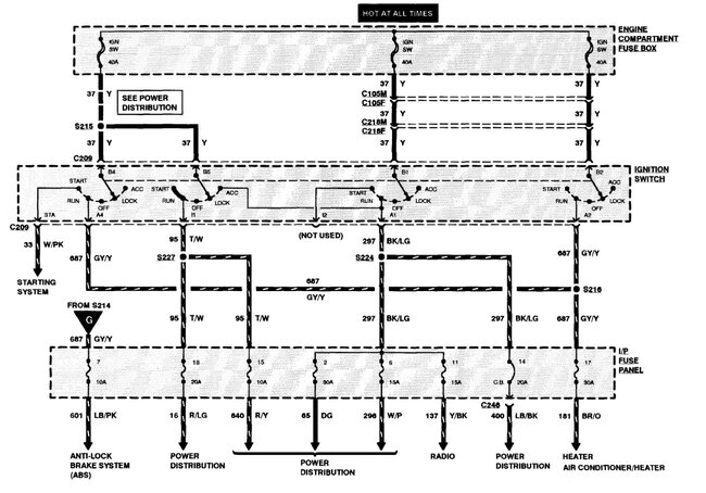

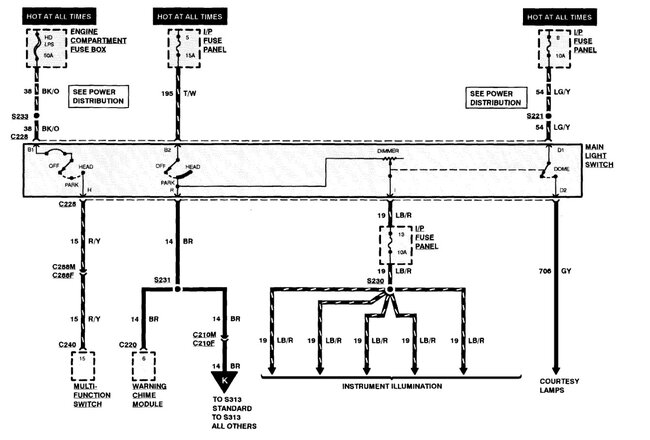

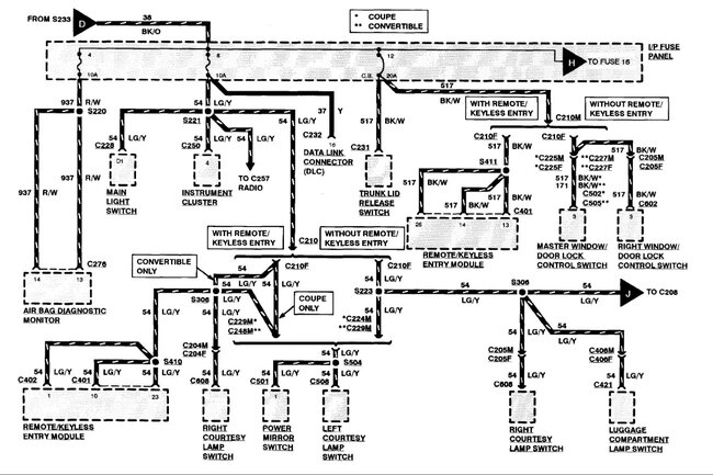

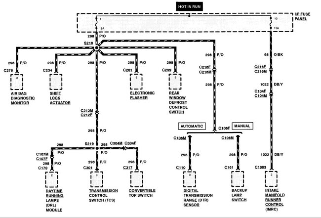

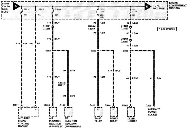

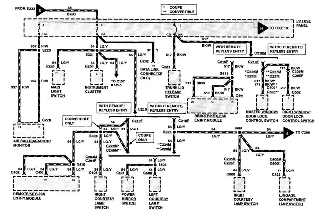

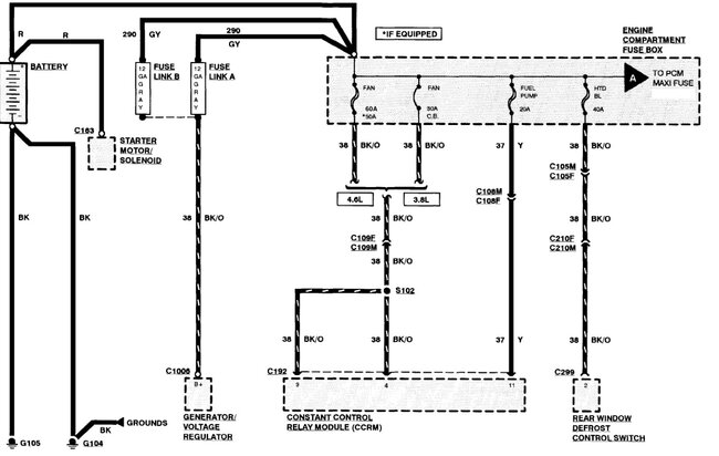

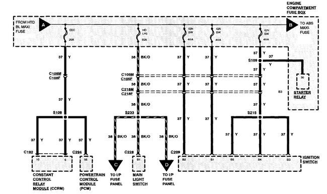

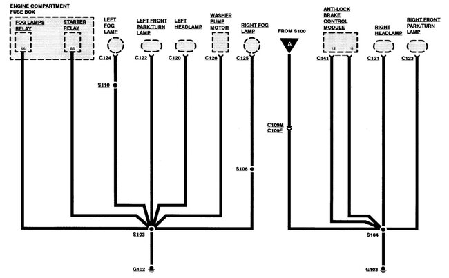

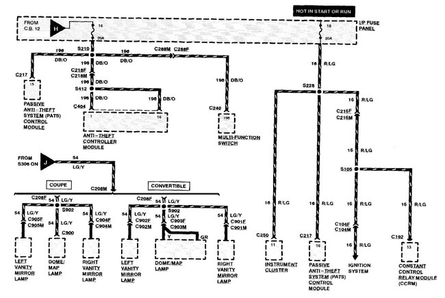

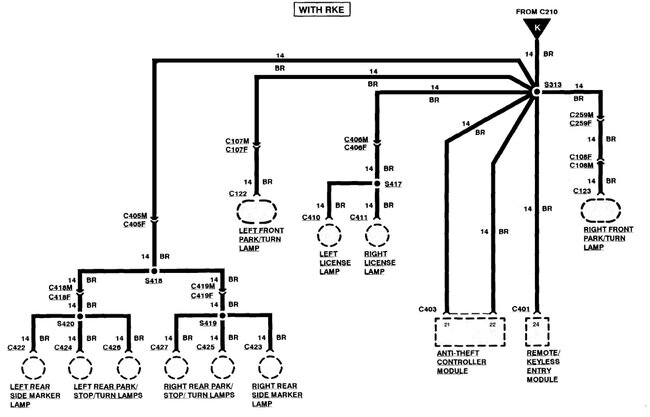

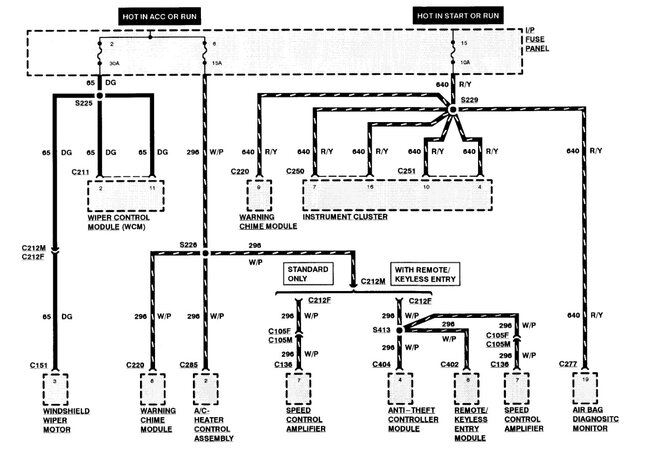

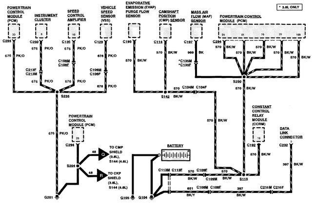

These are the OE diagrams in out service information. Not sure it covers every wire though as Ford likes to keep some secrets. You might want to look at this
https://charm.li/Ford/1998/Mustang%20GT%20V8-4.6L%20SOHC%20VIN%20X/Repair%20and%20Diagnosis/
it should have the wiring diagrams under the diagrams section.

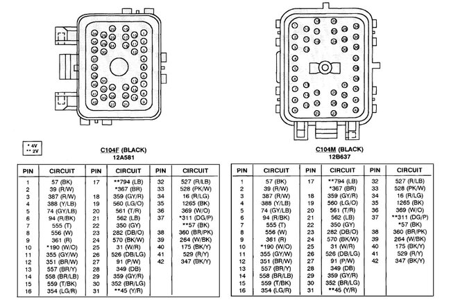

Thank you Steve. I have the charm diagrams. I was looking for a picture or pictures or even a wire color and its pin location in the ppwer distribution box chart. I have to repin a 99 gt donor box using the 98 harness wires.

Those show the colors and pins, not really easy to read but better than some. You do know the GT uses different parts that the other versions. There should be the interior fuse box and the under hood, Which are you calling a distribution box? Or do you mean some of the inline connections like the attached? Got a picture of what you are referring to?

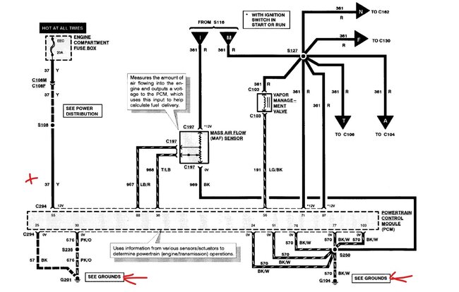

Pull the ABS fuses, you can drive it without that until you get it figured out. Define not going into gear, you shift and it does nothing, you can't move the shifter or? Bad idle - Starts and runs OK, but if you let off it shuts down or is the idle going up and down or you shut it off and it won't idle on restart? Those sound like there is an issue with the ECU not getting the proper powers and grounds. Like the battery power that hold the KAM info is dropping out. Check that the PCM has good power on full time and that the grounds are correct.

What do the data inputs look like on a scan tool? I would look over the sensors and control signals as those two engine families have some different parts. I suspect that is where the problem lies, the engine is causing an issue in the PCM and it's trying to go into limp mode because of it. I avoid doing swaps on pretty much anything newer than 95 unless I swap everything to go with it or if there is a stand alone system for it.
