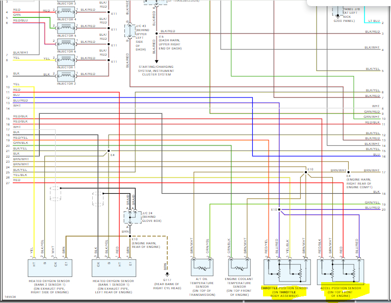

The acceleration pedal position sensor wire colors needed.

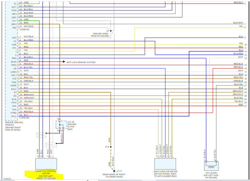

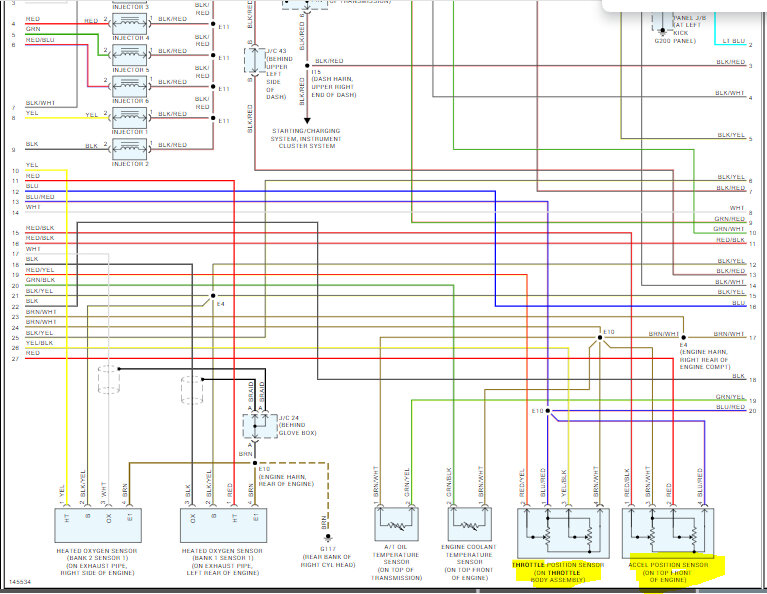

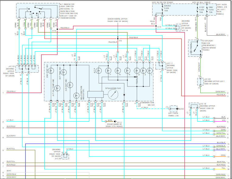

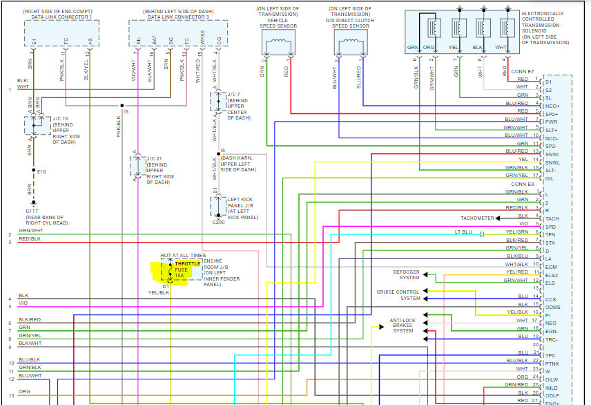

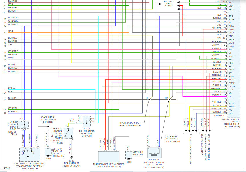

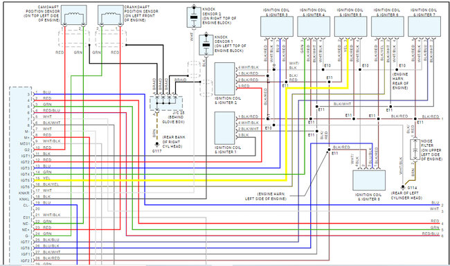

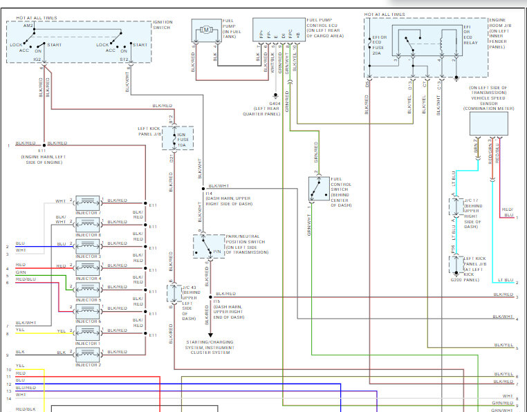

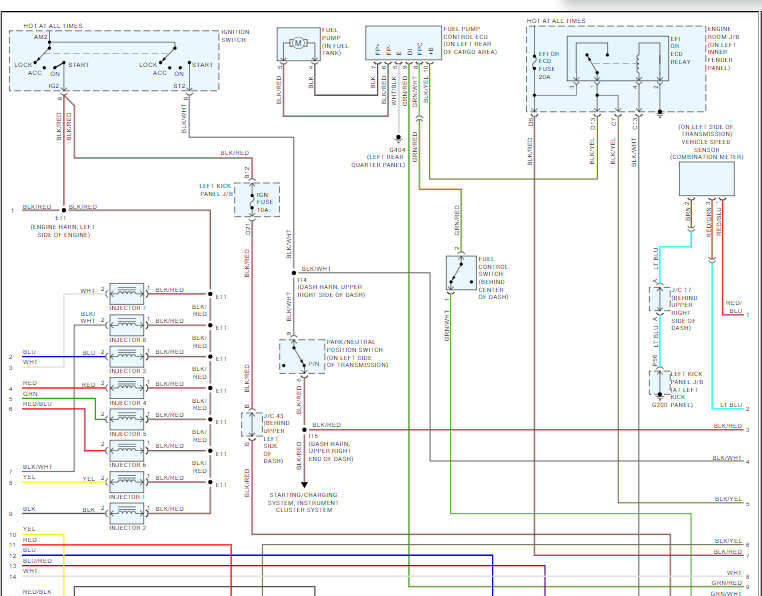

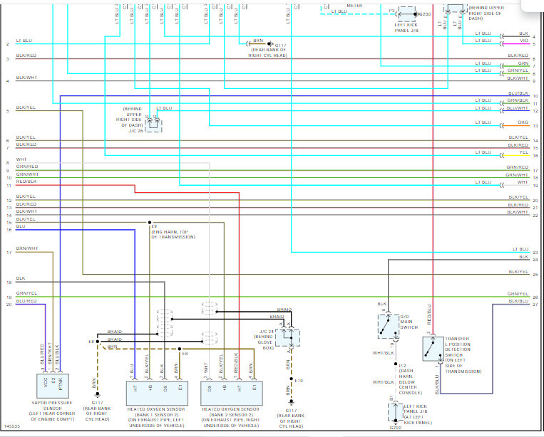

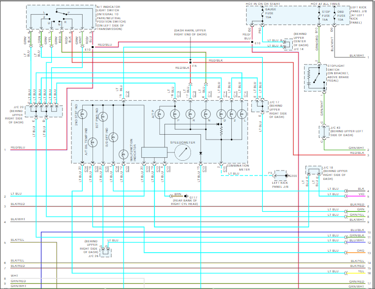

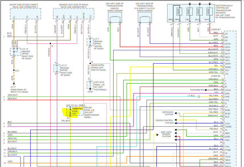

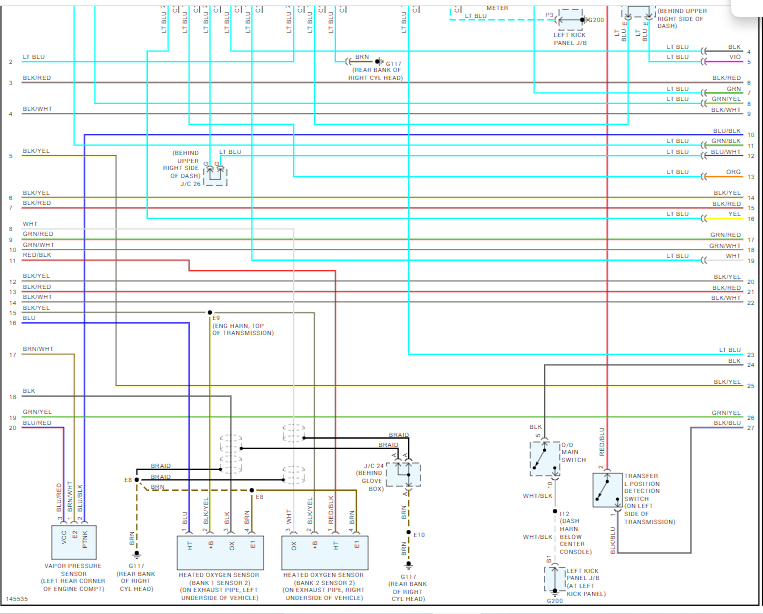

I went through my wiring schematics and couldn't find only APP info. So, I had to attach the entire wiring schematic for the powertrain control.
I highlighted everything I could find related to throttle control for you. Also, note that the schematic was 4 pages long. I had to cut each page in half to make them readable for you. I did overlap them so you can follow from one to the next.
Let me know if this helps.
