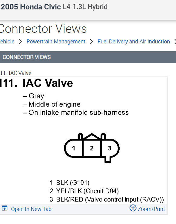

Wire color code for my new IAC idle air control connector needed?
2005 HONDA CIVIC HYBRID
242,000 MILES
BEELOW
MEMBER
1 POST
Don’t know the wire coloring code for the pigtail?
Apr 19, 2024 at 2:46 AM
Experienced Mechanic
55,694 POSTS
Sure, here is the connector pinout which shows the color of the wiring. Check out the images (below). Please let us know what happens.
