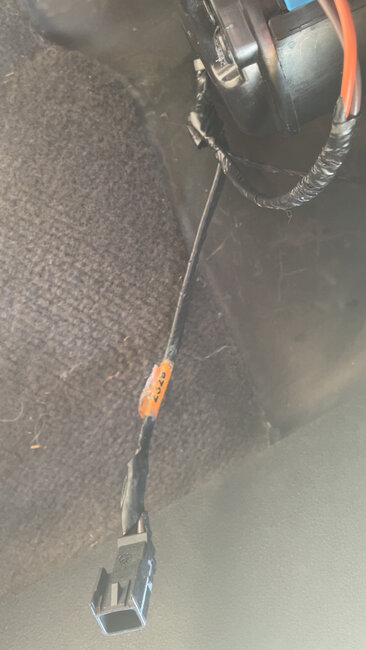

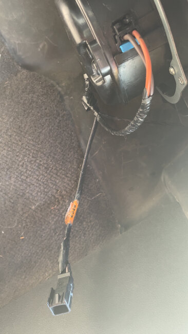

I replaced the heater core before I left for deployment and took the dash apart got it back together and the blower motor did not work so I just got done replacing the blower motor and resistor and I noticed that a wire numbered 2329 was hanging down I don't remember where it was.

HARKLESS278
  • 7 POSTS
the blower does not turn on but the blower motor is brand new with a new resistor as well, the blower motor is plugged in the brown wire does have a black wire with it and it does share the same harness extension as the resistor and the blower motor.

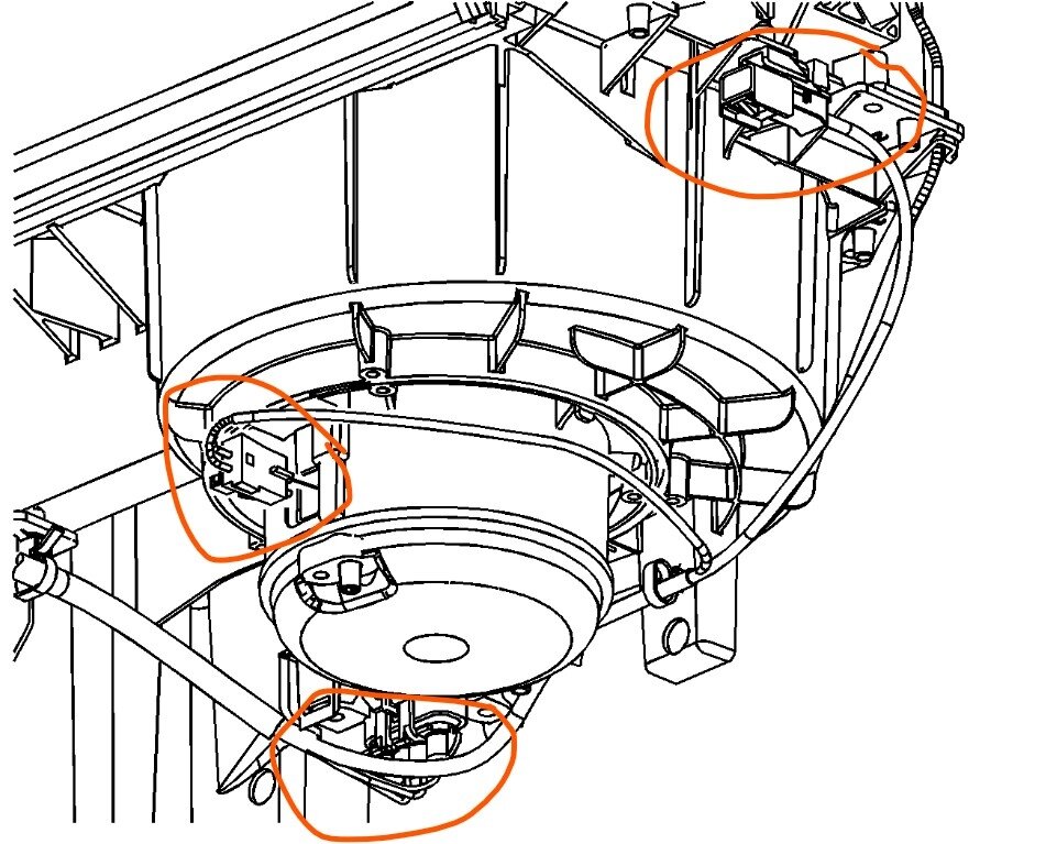

STEVE W.
  • 15,411 POSTS
OK, the wire should go to a socket up to the right of the blower housing. It has the blower power and ground in it, that is why the blower isn't working.

STEVE W.
  • 15,411 POSTS
No. It should plug in above the blower motor as shown to the upper right in this image.

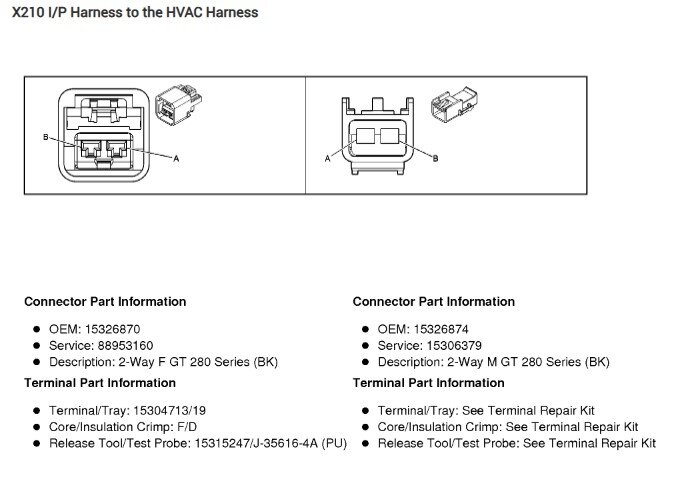

STEVE W.
  • 15,411 POSTS
It is connector X210 Just an inline connector. The brown wire powers the blower while the black wire is a ground. The attached is the OE info on it.
