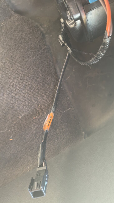

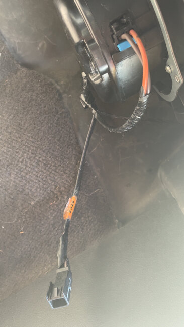

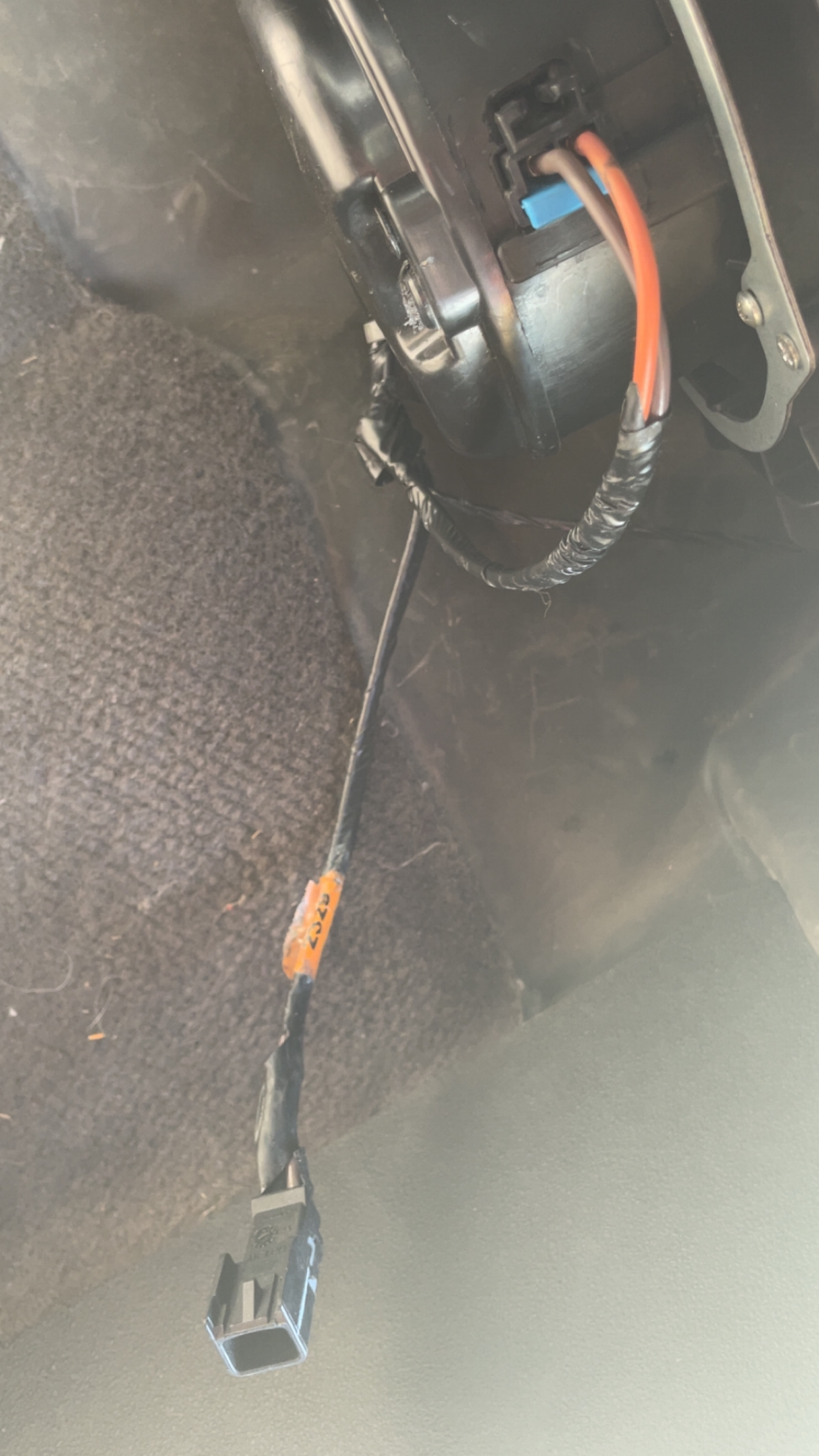

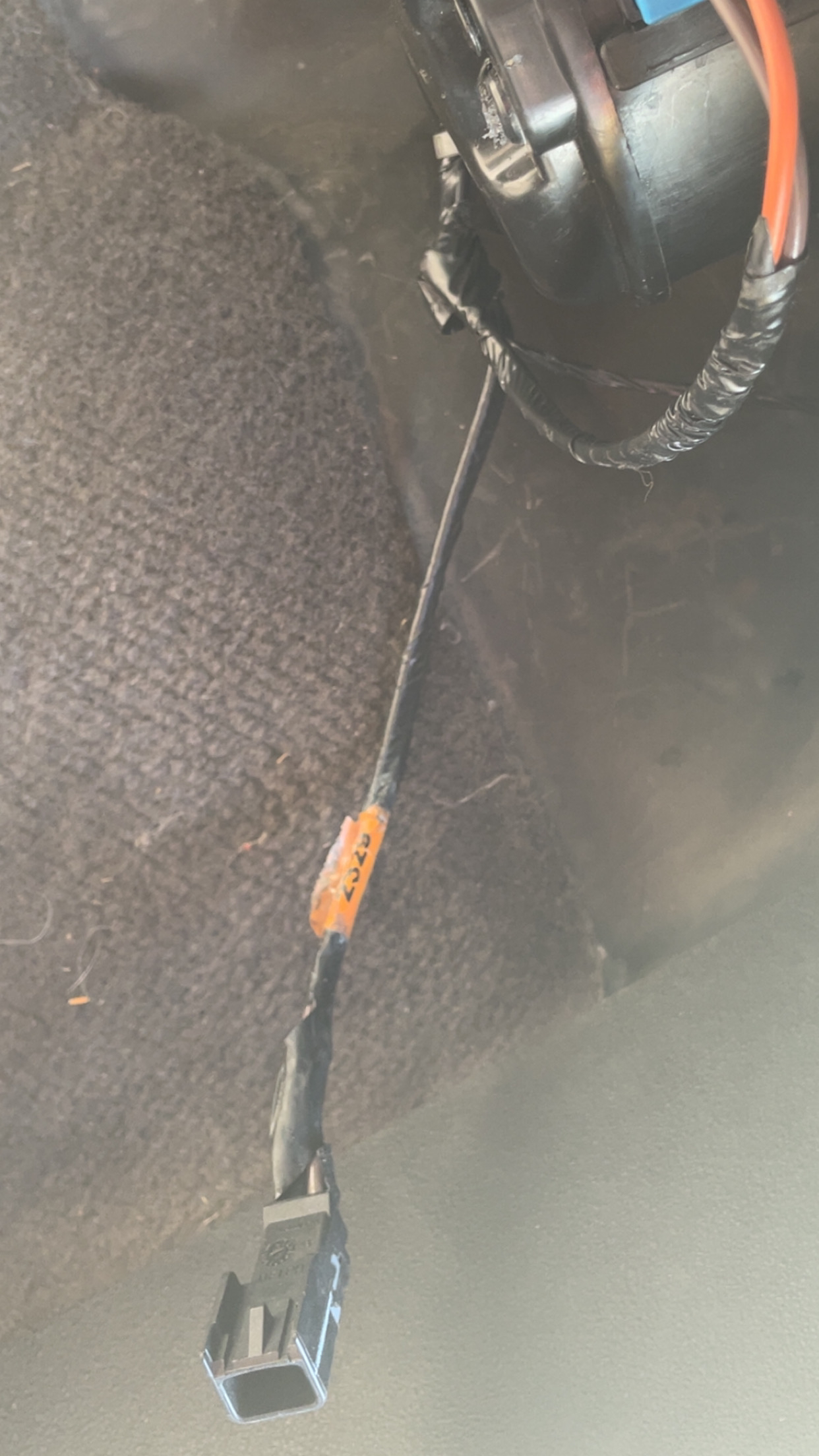

I replaced the heater core before I left for deployment and took the dash apart got it back together and the blower motor did not work so I just got done replacing the blower motor and resistor and I noticed that a wire numbered 2329 was hanging down I don't remember where it was.

one of the wires is brown by the look of it, and it has a black connector

OK, does the blower work? The only brown wire that shows near it plugs into the blower motor and normally is a 2 cavity connector X210 and it commonly has a black wire with it. It plugs into a short harness on the blower motor.
Nov 19, 2025 at 9:44 AM
HARKLESS278
  • 7 POSTS
the blower does not turn on but the blower motor is brand new with a new resistor as well, the blower motor is plugged in the brown wire does have a black wire with it and it does share the same harness extension as the resistor and the blower motor.

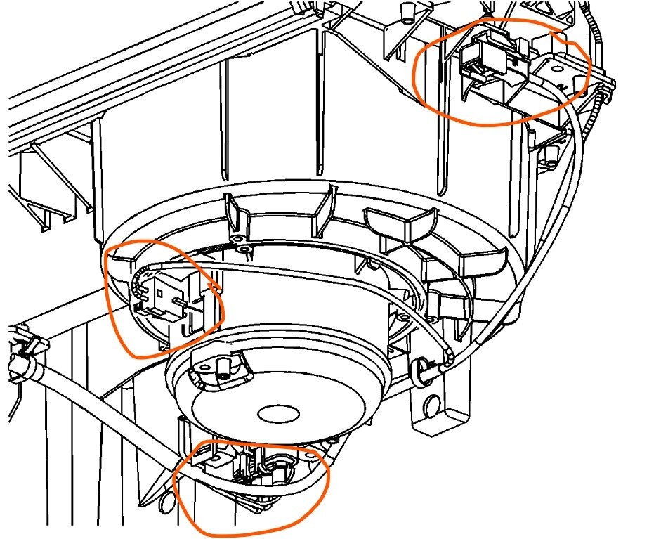

OK, the wire should go to a socket up to the right of the blower housing. It has the blower power and ground in it, that is why the blower isn't working.
Nov 20, 2025 at 2:52 PM
HARKLESS278
  • 7 POSTS
would I have to take the Dash apart to get to it?
Nov 28, 2025 at 10:23 PM
STEVE W.
  • 15,352 POSTS
No. It should plug in above the blower motor as shown to the upper right in this image.

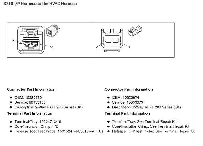

I figured it out the Plug itself is missing do you know what it is called?
Dec 5, 2025 at 11:33 AM
STEVE W.
  • 15,352 POSTS
It is connector X210 Just an inline connector. The brown wire powers the blower while the black wire is a ground. The attached is the OE info on it.
