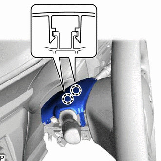

I use the wipers and go to turn them off and they just stay running only stop when I turn key off.
Nov 13, 2019 at 4:50 AM
  • 110,244 POSTS
Either the switch has failed or there is a short to power. My first suspect is the switch. However, I want you to try something. Remove the wiper fuse in the interior fuse box. See pic 1. See if they still turn on. If they do, then we have a short to power (a different power supply). If they don't, replace the switch.

Release the tilt lever, and fully extend and lower the steering column.
Lock the tilt lever.

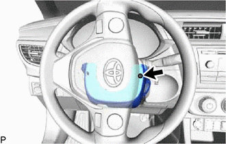

Turn the steering wheel assembly to the left and remove the screw.
pic 1

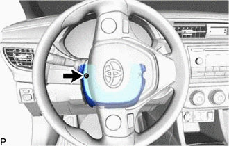

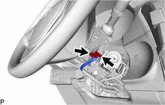

Turn the steering wheel assembly to the right and remove the screw.
pic 2

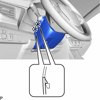

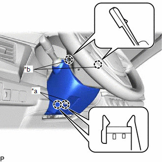

Disengage the 2 claws.
pic 3

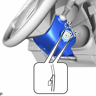

pic 4
Insert your fingers into the opening of the tilt lever of the lower steering column cover and disengage the 2 claws .
pic 5
*a Claw
*b Claw
HINT:
Spread the claw to disengage them.
Disengage the 2 claws to remove the lower steering column cover.

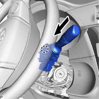

REMOVE WINDSHIELD WIPER SWITCH ASSEMBLY
Disconnect each connector.
pic 7

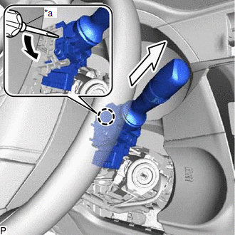

Turn the steering wheel assembly to the right.
Using a screwdriver, disengage the claw and remove the windshield wiper switch assembly as shown in the illustration.
NOTICE:
If the claw is pushed with excessive force, it may break.
pic 8

Turn the steering wheel assembly to the left and install the screw.
Turn the steering wheel assembly to the right and install the screw.
