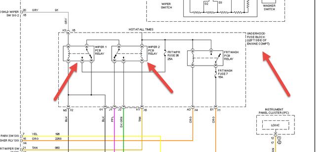

the wipers wont shut off unless the fuse is pulled,
the vehicle does not have the heater washer option.
replacing the motot/module assy changes nothing,
unplugging the multi function switch changes nothing,
unplugging the bcm changes nothing,
checked the plug and ground at motor and ran jumper per bulletin, no change,
no relay located in fuse block or in dash for wiper motor....
no dtc on system scan
bcm scan shows park request and it does not park just keeps running
any ideas

also in si ( gm web) and all data the 2006 and 2008 show relays the 2007 does not, but, it shows on a circuit diagram with no circuit number other than between motor and fuse block in the electrical path

I dont' want to soubt you on the wiper relay but this in our manual for 07/08/09 see pic. anyhow I have no further suggestions.

I appreciate your help.... but the fuse block does not have any relays labeleld pcb, nor wiper, nor wiper1 or 2
the fuse block lookd like the one shown for a 2008 in all data...
May 4, 2014 at 10:12 PM
HMAC300
  • 48,601 POSTS
looking at the 08 fuse panel which we don't have a pic of, there are wiper relays but are part of the fuse block and not serviceable so that may be your problem but I don't wan tto say for sure. these are printed circuit board relays. if you have used the fuse from harbor freight it' s possible that they have burnt the circuit broad up because they do not blow like they are supposed to. if you have any of these in your vehicles remove them immediately. they will have no numbers on top of fuse so easy to id. I have no further suggestions sorry.
