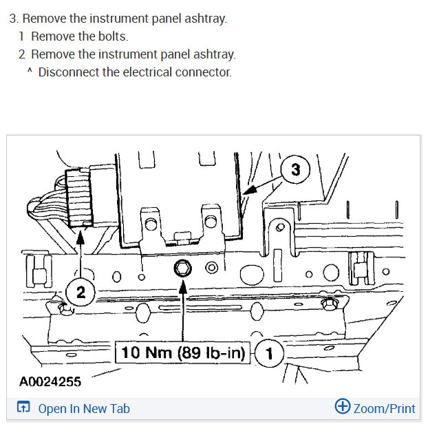

Wipers only work on high, where is the wiper control module located?

I cannot for the life of me find the wiper control module! I've read the posts here, bit no joy.

Found it behind and above ashtray.

Sorry it took so long to get to you. Here is an image of the location so well the next person who needs it. Check out the images (below). Let us know if you need anything else.
