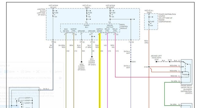

What would cause my wipers to not work? Fuse inside car is good which leads me to the fuse box under hood, not sure what to check here. please help
Jun 19, 2020 at 1:16 PM
Good afternoon,

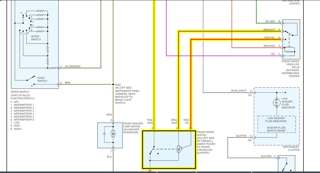

I attached a wiring diagram for you to view. You need to test the tan/red wire for power with the key on.
Let us make sure there is power for it to work.
