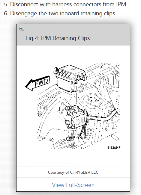

Hello, the turning signals, windshield wipers and high beams, horn just stopped working. I checked every single fuse and relay with an ohm meter for resistance etc., all checked out I even swapped them all around just to see if that would help. I checked both fuse boxes under hood and in trunk. I replaced the steering column control module and still nothing. Is there another relay under the dash I am missing or something? Help Please!
Thank you, Josh
May 14, 2019 at 12:50 AM
  • 55,256 POSTS

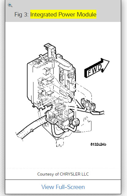

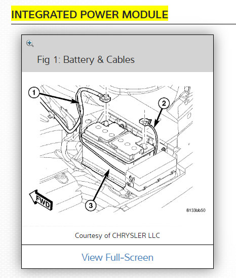

This is common when the TIPM goes out which you can replace yourself because it self initializes. Check out the diagrams and instructions (below). Please let us know what happens.
May 15, 2019 at 3:41 AM
SONOFNUN777
  • 6 POSTS
Thank you we replaced the TIPM last night and the problem remains the same. Is there anything else that can be done? Can the TIPM be tested?

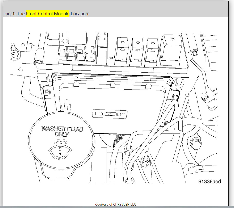

When you did the TIPM did you do the front control module? I see they are separate on this car.
Here is the test and the diagrams below

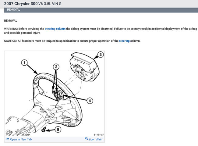

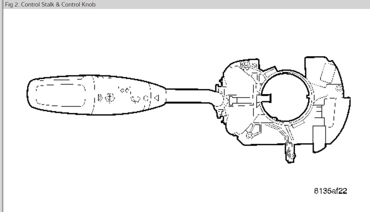

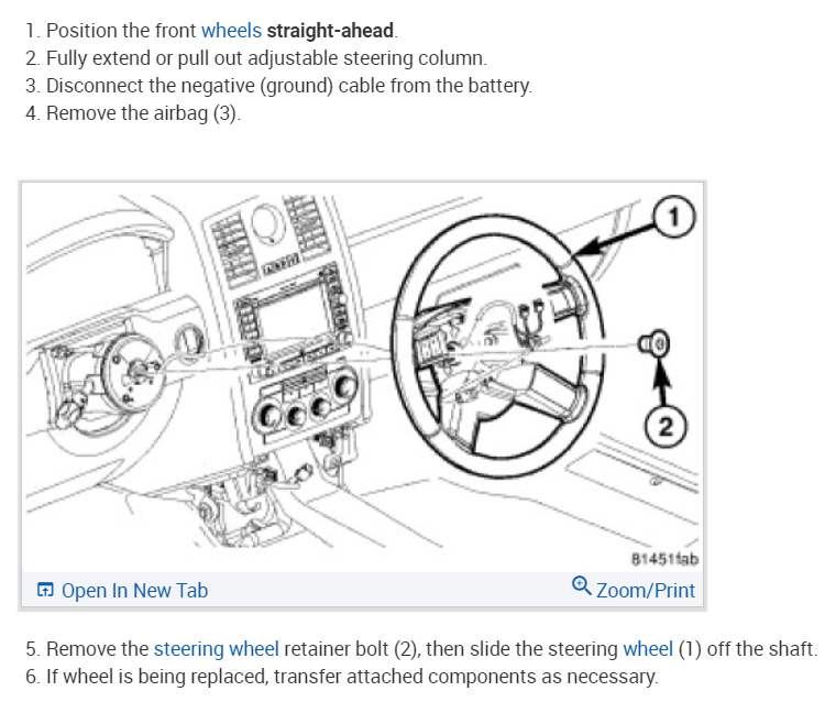

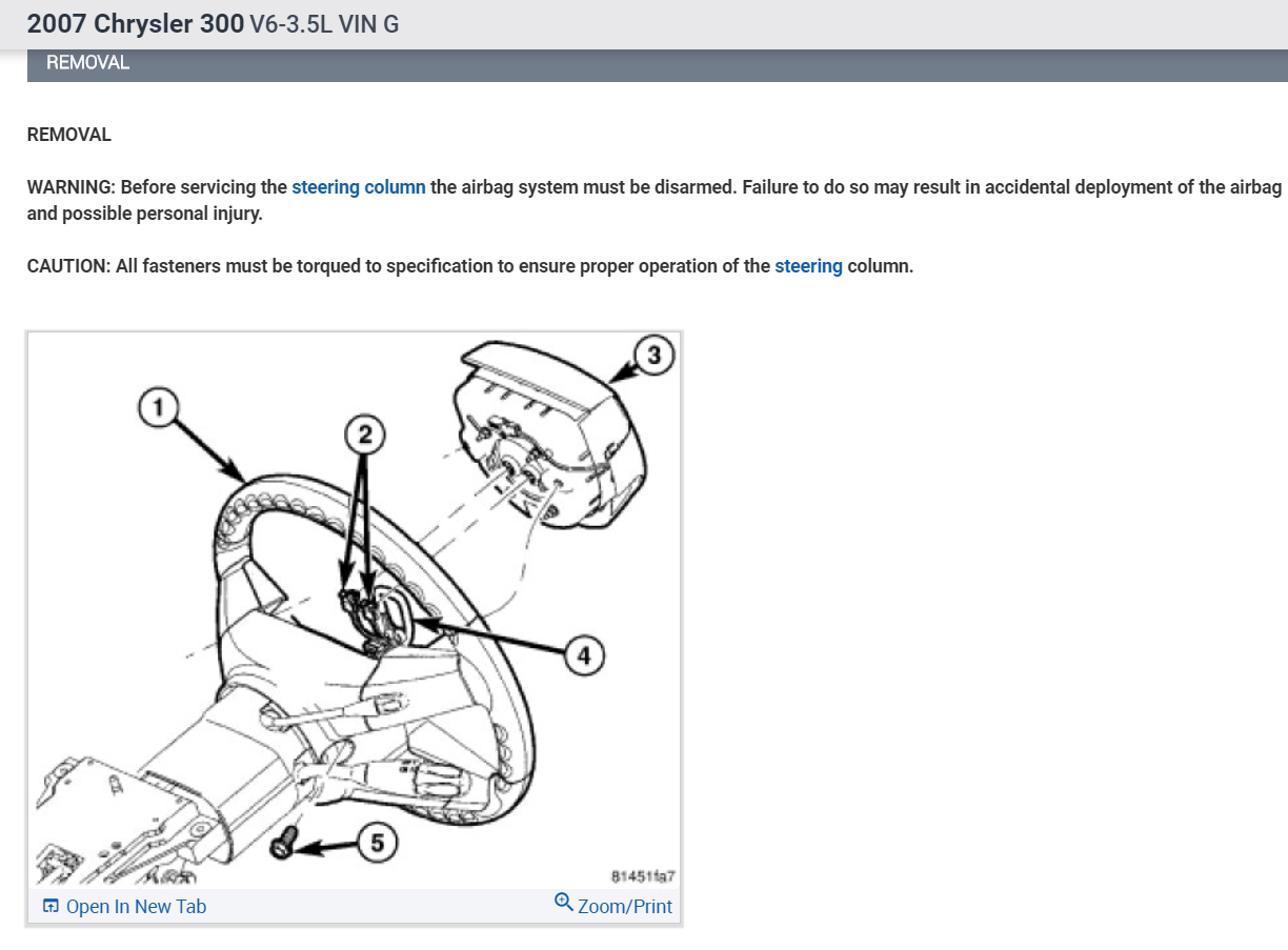

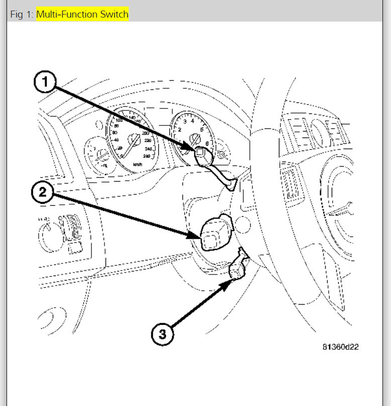

Thank you. The front TIPM was replaced also the Steering Column Module. I guess I could try replacing the actual lever switch the turn signal switch that encompasses the windshield wiper and turning signal as well as high beams.
May 16, 2019 at 6:16 AM
  • 55,256 POSTS
That would be my next move. here are pictures of the switch it looks like you will need to remove the steering wheel this guide and instruction below will help.
https://www.2carpros.com/articles/steering-wheel-removal

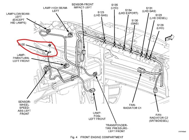

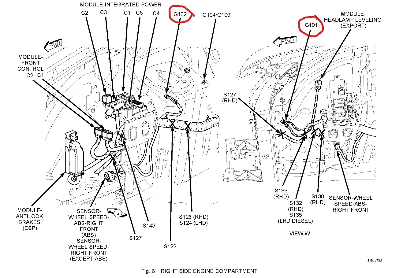

My problem is pretty much the same, my car sat for a while maybe 3-6 months before I replaced the alternator and the battery but after that the radio, wipers, horn and turn signal did not work. I was able to replace a fuse for the radio but still the wipers, horn, and turn signal are not working. I have since replaced the multifunction switch and the clock spring but still no fix. Is there anything else you can suggest?
Oct 19, 2020 at 10:05 PM
STEVE W.
  • 15,311 POSTS
DBATTLE, could you please post what your vehicle is so we can look at the wiring to determine which circuits are connected.
Oct 21, 2020 at 2:55 AM
WILLIE MITCHELL2
2007 Chrysler 300 2.7 L motor.
Dec 25, 2024 at 12:11 AM
STEVE W.
  • 15,311 POSTS

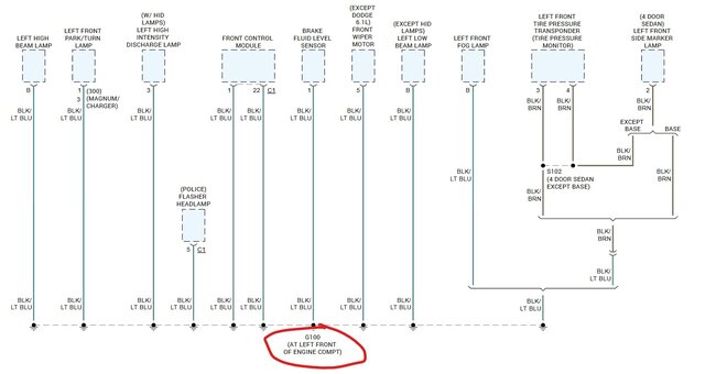

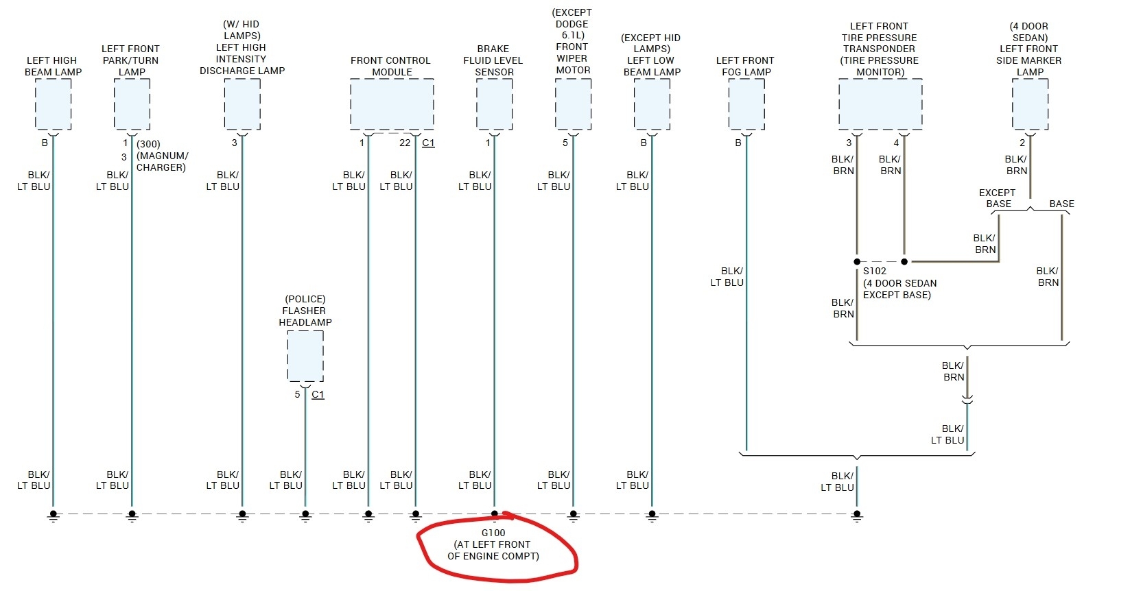

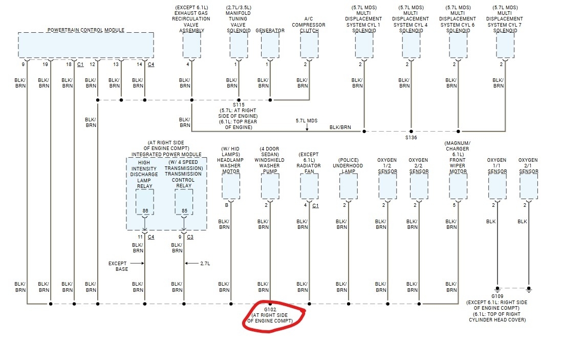

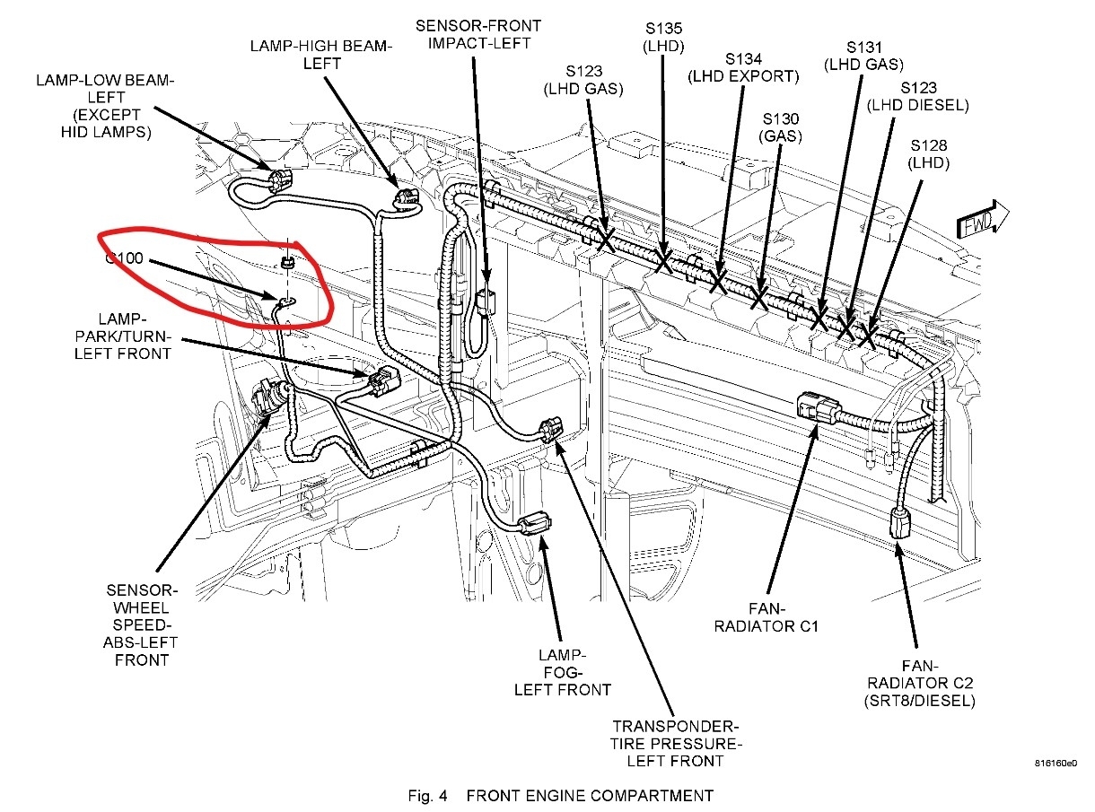

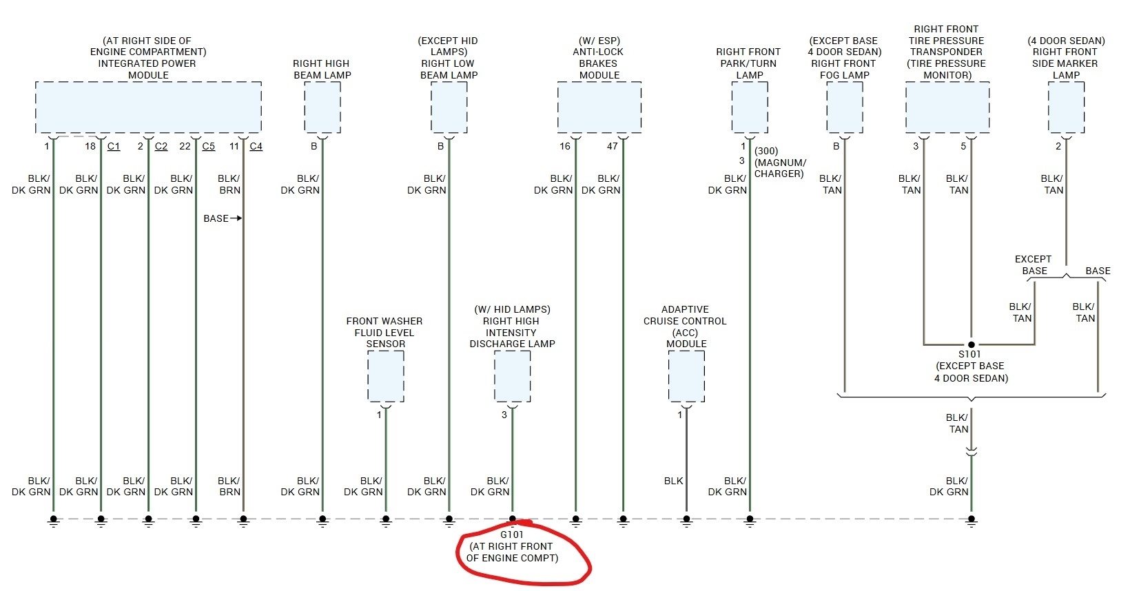

Okay, with multiple systems showing a fault on a Chrysler I'm going to suspect a bad ground point. The engineers thought it was a good idea to take a lot of individual ground wires, bundle them together and then crimp them all into a single eyelet and onto a single bolt. Usually there are 6-10 wires bundled together and in your case, those meet up at ground point 100 and 101. I would say to give each wire a good tug but have the parts to repair them handy. I would also check the other ones in the front, rarely do I find just one bad ground. If you look at the first two images you can see where the grounds are bolted in place, notice how it looks like 3 wires? The other three images are the actual numbers of wires at each of those ground points. Just a few more than 3.
Here are a couple examples of what you are likely going to find - These are on Jeeps, but the entire product line suffers the same issues.
