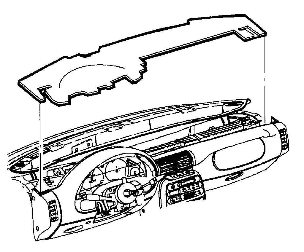

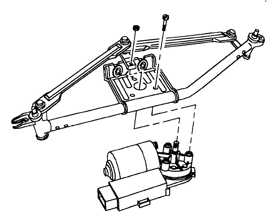

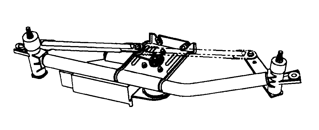

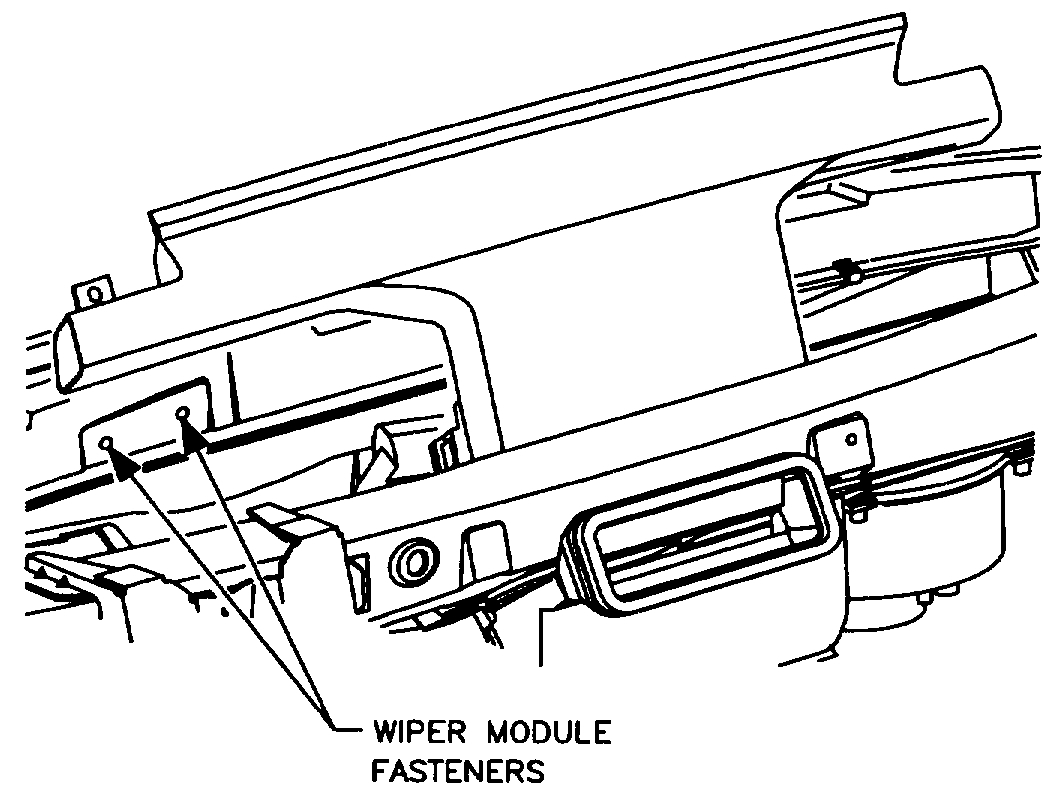

Here are the directions specific to your vehicle. I noted that the wiper motor crank arm need positioned at 9 o'clock when installed. Take a look through these and let me know if they help. The attached pics correlate with the directions.

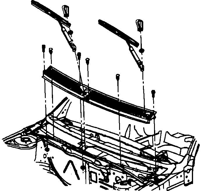

1. Remove wiper arm finish cap and wiper arm fastener. Lift wiper blade assembly away from windshield and remove wiper arm from pivot.
Fig. 5 Windshield Cowl Trim Panel Removal
pic 1
2. Remove fasteners at windshield edge of cowl trim panel. Open hood and remove remaining cowl trim panel fasteners, and remove cowl trim panel after disconnecting washer hose.
3. Disconnect windshield washer hose.
Important: Exercise care when removing instrument panel top cover to keep from scratching windshield garnish moldings.
pic 2

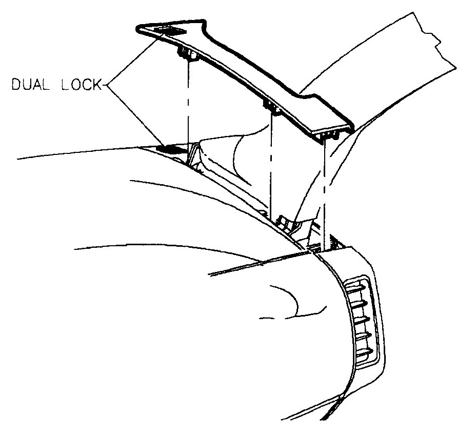

4. Remove upper trim panel extensions by carefully lifting up at clip locations, starting at the rear above end cap.
pic 3

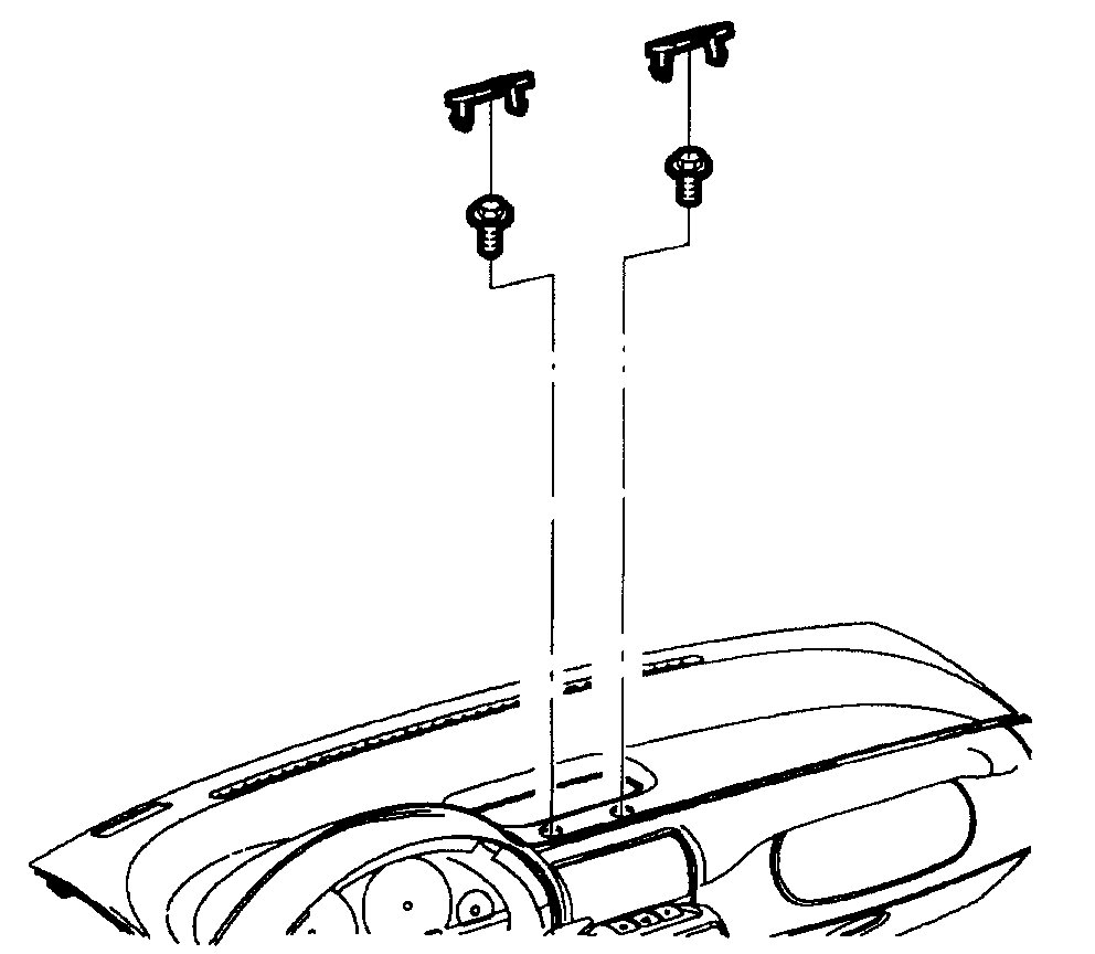

5. Remove upper trim panel screw caps by carefully prying up with a small screwdriver.
6. Remove upper trim panel screws.

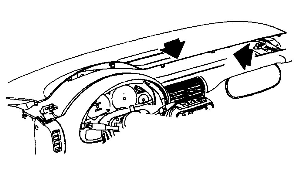

7. Lift upper trim panel at clip locations on rear edge to disengage clips.
pic 4
8. Pull panel rearward out of clips at bottom of windshield.
9. Remove upper trim panel.

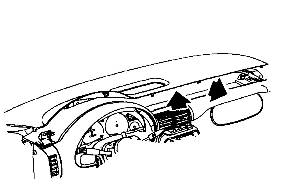

pic 5
10. Remove upper trim panel insulator.
pic 6

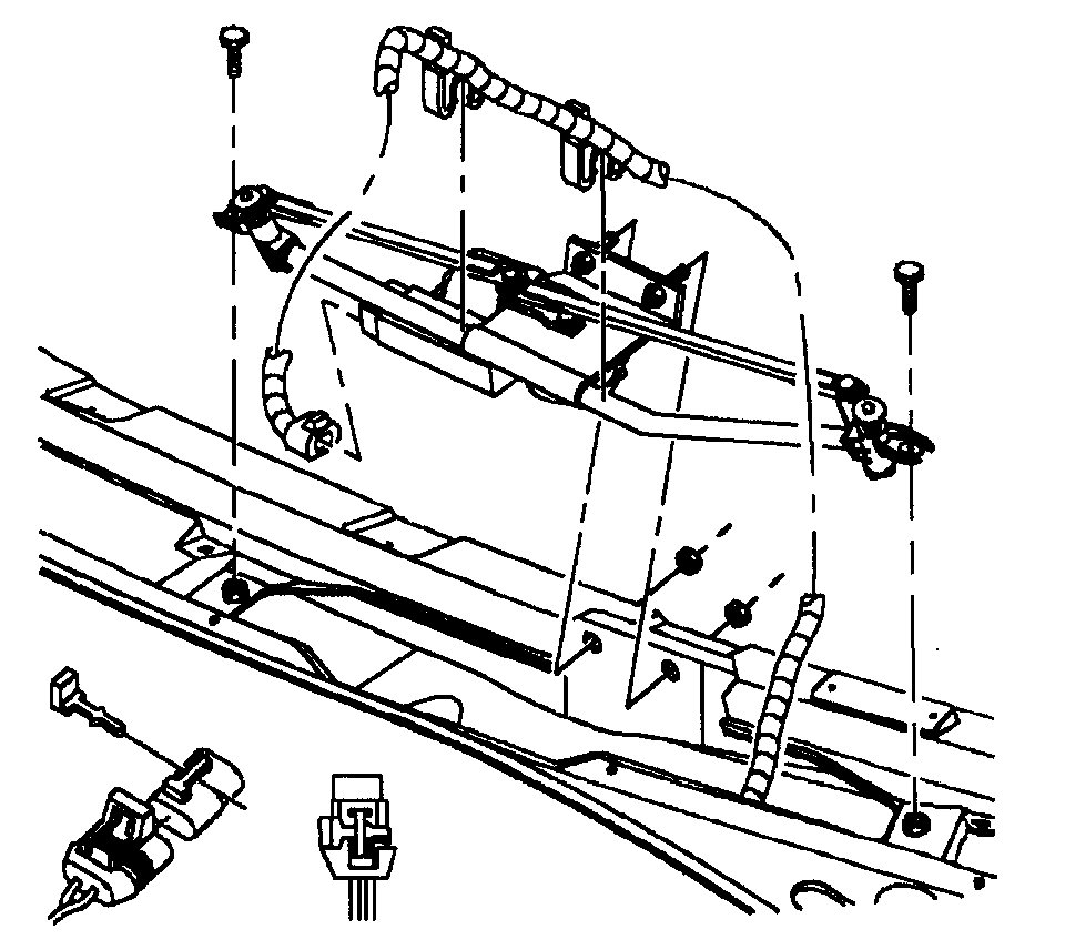

11. Loosen A/C defroster duct and move to the right to expose wiper module fasteners.
Note: Use care when removing wiper module from cowl to avoid pivots contacting windshield
pic 7
12. Remove wiper module fasteners, partially remove wiper module and disconnect wiring from motor and module frame. Remove wiper module.
pic 8
13. Remove crank arm nut and disconnect crank arm from motor shaft.
14. Remove wiper motor fasteners and remove wiper motor from wiper module.
Installation
Important: If installing new wiper motor, remove wiper motor crank arm from new wiper motor assembly and discard.
1. Connect wiring to new wiper motor and turn wiper control on momentarily. Once wiper control is turned off, wiper motor will be in the PARK position.
2. Install wiper motor onto wiper module.
Torque: 10 Nm (89 in-lbs)
pic 9
3. Position wiper motor crank arm at 9 o'clock position, and install on wiper motor shaft.
4. Apply Loctite 242 (or equivalent) to wiper crank arm attaching nut and install.
Torque: 28 Nm (21 ft-lbs)
pic 10
5. Partially install wiper module assembly, connect wiring to wiper motor and to module frame.
6. Install wiper module assembly.
7. Turn wiper switch ON momentarily. Once wiper switch is turned Off, wiper mechanism should be in PARK position with wiper motor crank arm in 9 o'clock position.
