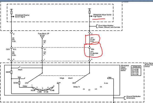

What kind of diagnosis can I do from either side of 3 pin washer wiper connection on the multi-function switch? Can I test the function/continuity of the switch? I have 12 v showing on the harness side of switch on both blue and yellow wires with key on. By the way, delay, slow, washer all work fine. What other circuits to test.

In the wiper switch in the vehicle, there are resisters. When it is on high, power is direct 12v via the dark blue wire with a white tracer at the switch which goes to a dark blue wire at the wiper motor module. Check to see if that wire has power when you place it on high speed, key on.
Let me know what you find. I did attach a picture of what I am referring to. Here are a few links you may find helpful:
If you do have power out at the switch, then check to see if there is a connection issue at the module.

If I unplug the connector from the multi-function switch I get 12v showing on both the blue/white wire and the yellow coming from the module when the key is on . Not even connected to switch so does it need to be turned to high?

That is correct. The switch, when connected, supplies ground. I suspect the switch has failed.

So bad switch or maybe bad ground in the column since my horn has been intermittent too . Am I safe to take out switch and or airbag to check grounds with just the SIR fuse for the airbag removed or do you think disconnecting both batteries is better? Thanks so much for the help!
