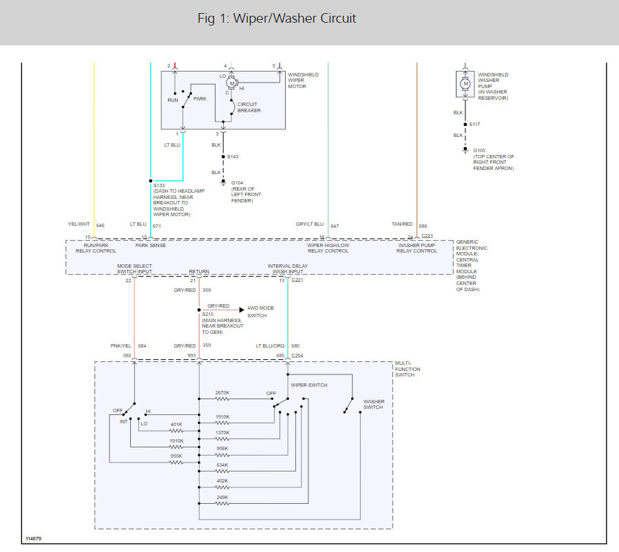

Intermittent issue with wipers not working
1999 FORD RANGER
125,000 MILES
BOBRYE63

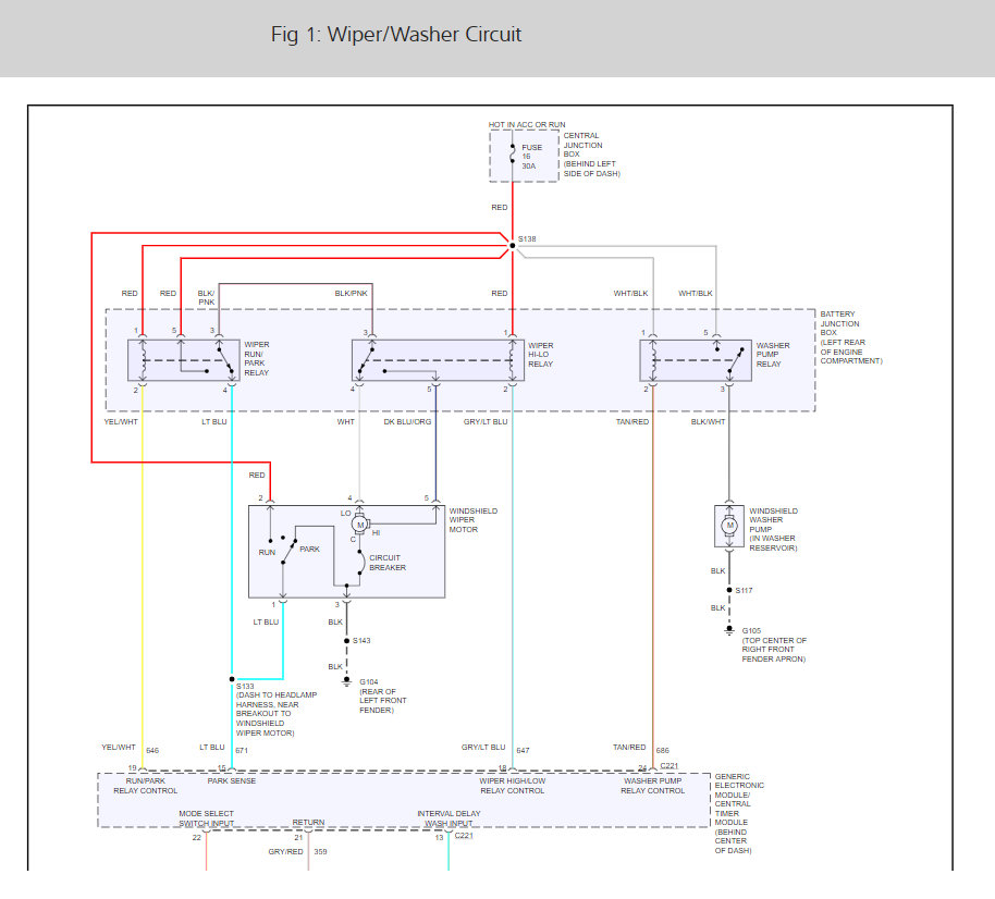

Wipers work when they want to. I changed the motor and wiper handle. I hear clicks but wont work. Why?
Aug 17, 2019 at 9:59 AM
  • 54,837 POSTS

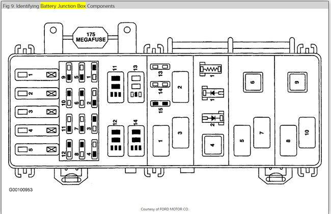

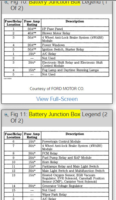

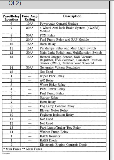

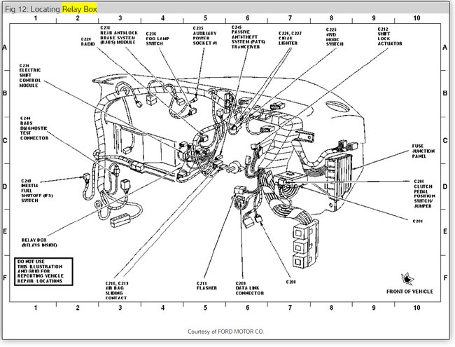

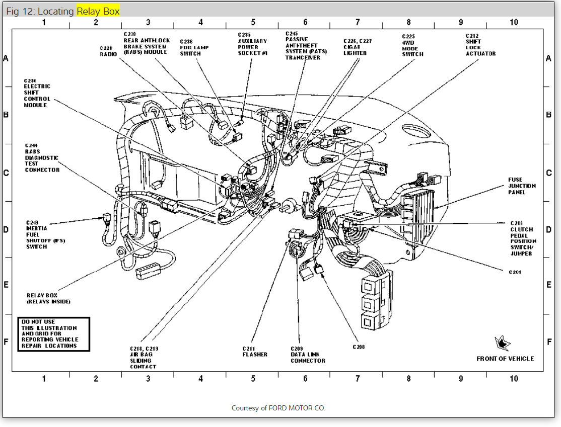

It sounds like you have a high/low relay that is not working right. To be sure here is a guide to help you test the relay and the wiper wiring diagrams so you can see how the system works with the relay locations as well:
