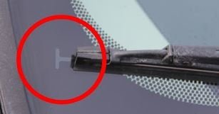

When using my windshield wipers the left one in front of the driver keeps hitting the side of the car where the glass and the car meet not on the tip but on the side. The wiper blades that are on there are the correct size. Do you think I might need a new arm? Please help.

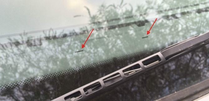

It could be that the arm is bent, especially if you live in an area where you get snow, as it can cause a higher load on the wipers. A quick check to see if it is bent is to look at where the blade and arm set when the wipers are off. Most windshields will have small marks in the inner layer that show where the wipers are supposed to be when they are in the park position. They can be hard to find on some and out in the open on others. If the glass has been replaced they may not have them though. In that event most wipers will park in line with the lower trim line on the windshield.
