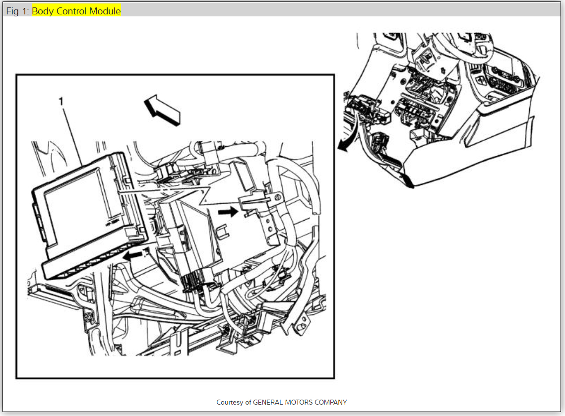

Hey, my windshield wipers stopped working, but when I try to turn them on my headlights come on.

lol, that is funny. It sounds like the BCM has gone bad which you will need to get programmed into the truck which should cost about $130.00 if you have your own BCM here is the location of the unit. I would remove the unit and check the connectors for corrosion from moisture which will cause the issue.
