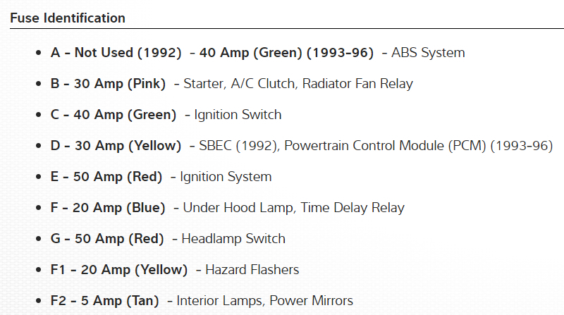

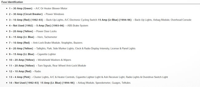

Windshield wipers quit working.
Jan 11, 2020 at 12:08 AM
AL514
  • 5,668 POSTS

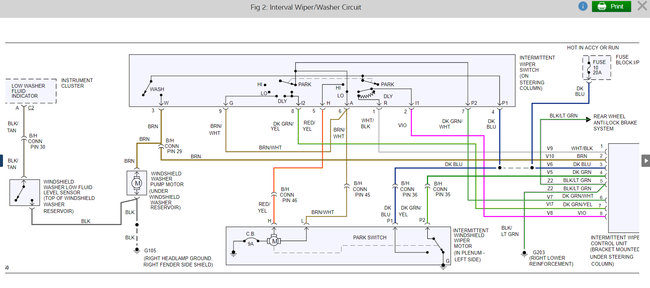

Hello, the wiper motor needs to be checked for power (12volt), if there is no power while turning the wipers on, then most likely the wiper switch is bad. it's usually called a combination switch. The body control module may be malfunctioning as well. It controls all the lights,wipers, turn signals etc.
https://www.2carpros.com/articles/how-a-car-electrical-system-works
Jan 11, 2020 at 1:28 AM
  • 55,433 POSTS

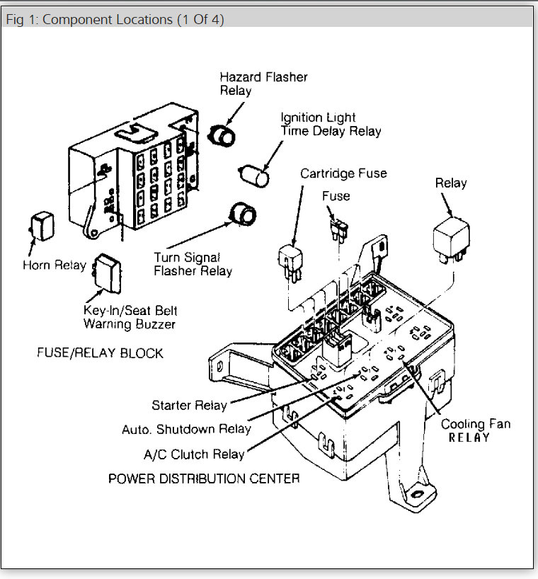

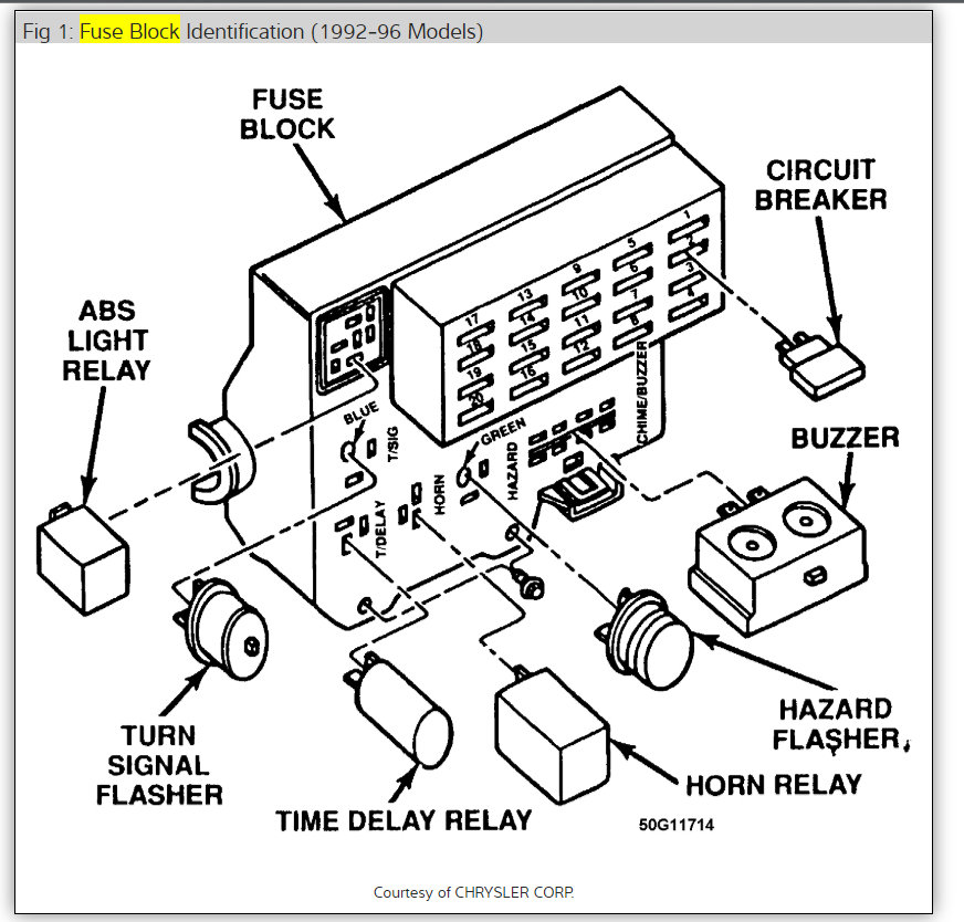

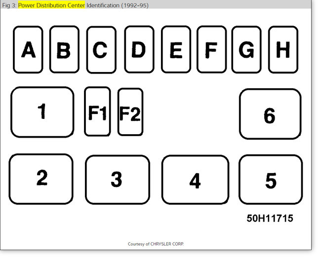

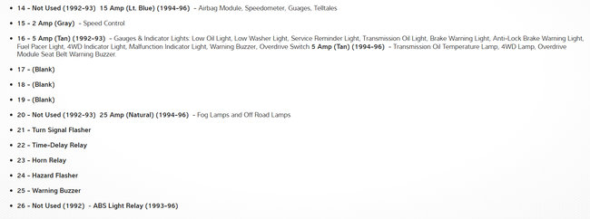

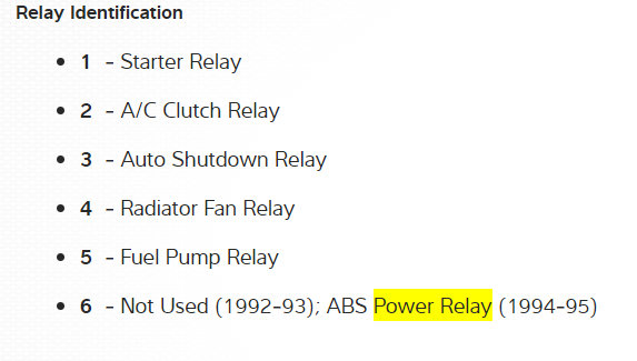

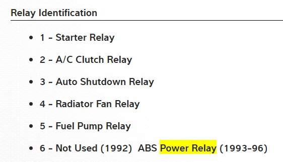

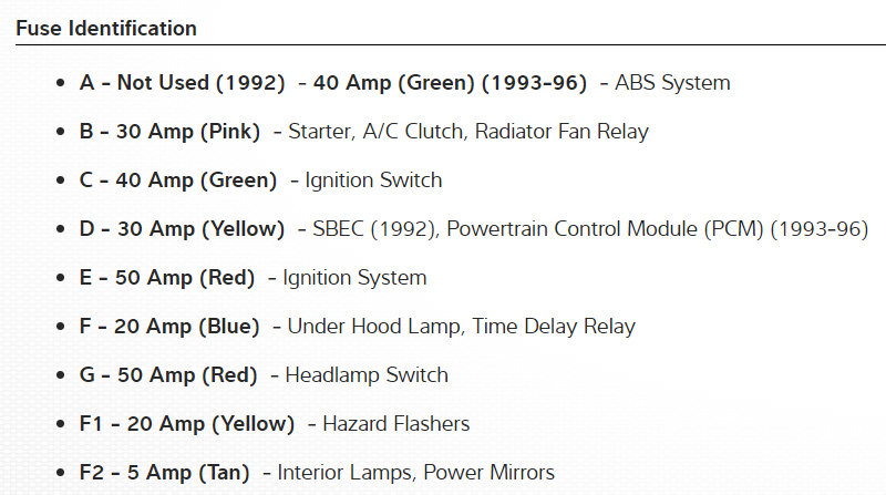

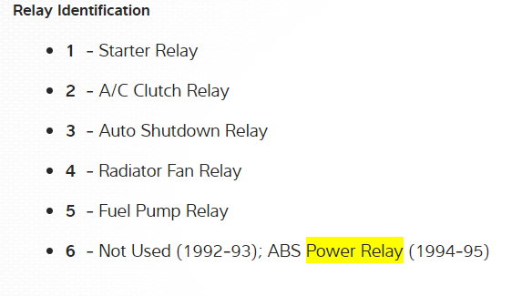

Here is how you can check the fuses and the fuse panel locations as well in the diagrams below, I also have the wiper wiring diagrams so you can see how the system works.
