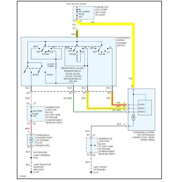

Wipers worked yesterday, I left them on when I shut truck off. snowed and froze overnight. started truck this morning forgot I left them on when I went to turn on I realized they were on. now they don't work. thinking they were frozen to window and blown fuse. I checked 25 amp fuse in box and was still good and still don't work. any ideas what to check next?
Nov 1, 2019 at 10:07 AM
Good afternoon,
You need to test for power to the motor itself. It may have burned out the wiper motor.
I attached a diagram for you to view. Check for power to the motor on the highlighted wire.

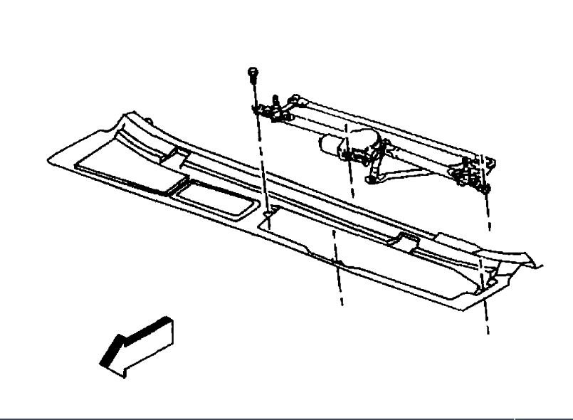

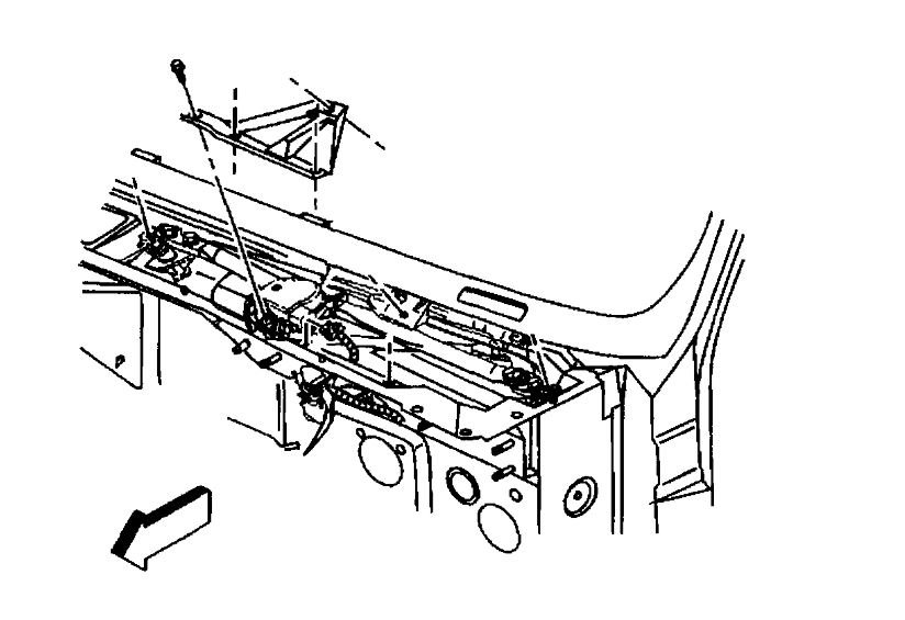

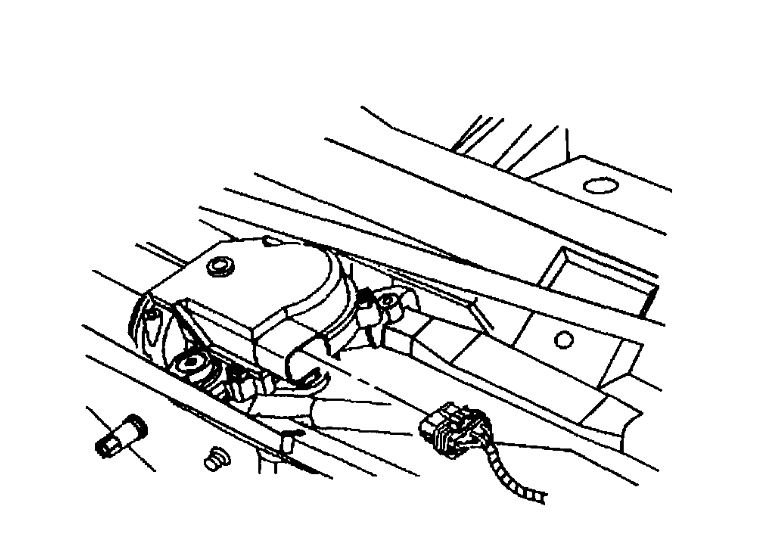

REMOVAL PROCEDURE
TOOLS REQUIRED
J 39232 Wiper Transmission Separator
1. Remove the wiper arms.
2. Remove the air inlet grille panel.
3. Remove the four bolts and the reinforcement panel.
4. Disconnect the electrical connector from the wiper motor.
5. Remove the two bolts from the wiper transmission assembly.
6. Remove the wiper transmission assembly from the vehicle
