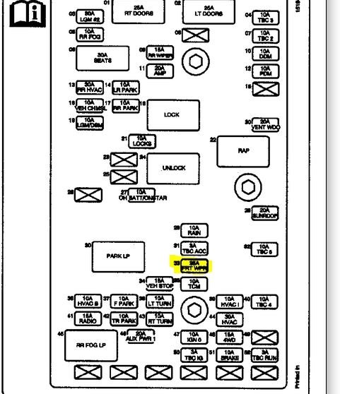

Wipers will not turn off. I have seen the other post that explains what the causes may be. I do not have time to repair it until next week. I need a quick temporary fix to get them turned off. There does not seem to be a fuse.

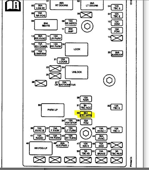

If all you need is the fuse information, I am attaching pictures of two different fuse boxes. You should have one of them under the rear seat, driver's side. The different boxes are for short wheel base and long wheel base models, and I am not sure which you have. The fuse for the front wipers is highlighted in each image.
